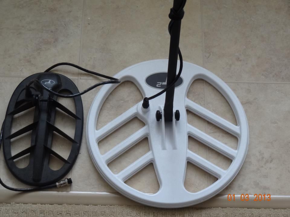

Got the T2 SE 15 inch coil in the mail last thursday, this coil had a couple runs down the beach so far but was brought for detecting the local abandoned ovals who are a century or more in age.
So far testing on the beach has been amazing, depth is what you expect from 15 inch coils and i have used a few of them or larger coils on various machines in the past.
With this coil i got 2ft or 24 inches digging a inch round pipe at the beach, this had a strong signal.
The coil is stable on the beach, its got a wide coverage, quick to id targets and best of all the size is a real head turner! 8-)
The weight is comparable to other large coils i used in the past, I carry in my car a $2 home made harness kit, which makes the T2 float on air and takes away any weight the coil has added.
Pinpointing is precise, i can pinpoint within a inch of the target and over all i found the coil down the beach yesterday worked perfectly.

What is the added weight of the 15"? One of the benefits of the T2 is how light it is without sacrificing performance.

The 15" inch coil is way heavy. It does go deeper - I dug at three ringer Civil War bullet at 2 1/2 feet as God is my witness - but man, I paid for it in pain. If you want deep and don't mind the weight, get a Minelab. The T2's awesomeness is great depth and little weight. The wear and tear on my elbows was not worth the extra depth. I can cover more ground and feel pretty certain I'm not missing anything with the stock coil than with with the 15".
yes 15 inch coil is going real deep but i agree is very heavy, i use a ocky strap and a lanyard now as a really cheap harness, makes it light as a feather.
Ozzie, any way you can post a picture of your setup? I would love to see it.
