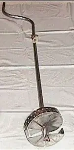

SurfDigger, Sandman, and any of the other older hunters out there......I've been thinking about this...Making a sand screw for the ruff water's. I had a make shift one along time ago, got a picture around here somewhere....But the idea of being total stable in the surf would be a great advantage, and the screw would provide this while screwing into the sand. This would only work on sandy beachs, with maybe a few shells. On how to use one is you find your target, PP..then center your screw over the target and turn away, and about every 3 or 4 turns you would shake it alittle, this forcing the sand thur the small holes, along with the turning would force sand thur. Mine had a lever on the side to close the small trap door, capturing the items that would not past thur the 3/8 inch holes. Anyone that can PP, could nail the target, and the whole time you would be able to take the waves because your nailed to the sand ......Any input on that guys? Found a pic of one up close, some mods would have to be done to keep the targets in place, or again timing of the waves, along with a teather to the detector...
This almost sounds like a Overkill Overkill idea :-\

Joe....someone invented one of those already...he was in California...I still have one it is verrrry limited where you can use it....the sand has to be pretty clean...here is a pic of mine....
