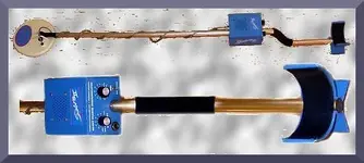

Estate sale this weekend has a Tesoro Sabre II for sale. The control box is blue and just says Sabre II. Also, runs on a single 9volt. I am unable to find any info on these as the Tesoro manuals have the silver & golden Sabre IIs, but if I recall they are brown/gold/black colored boxes...Any info appreciated(value too)...Im just looking for a decent little unit for my 7 year old nephew.

PS: Coil is solid(no hole) white, concentric discriminator.
Bit odd the colour. After the Mk 1 which had its own rather stylise control box I only remember the Sabre II's having the brown control box. Coil for these was the 8" concentric with the open centre though I think there was an 8.5" that was solid plus 4" and 11" as other options.
Frequency was 12 kHz and the II used Tesoro's ED 120 expanded discriminator that's non linear and provides plenty of width down the lower range.
If its working correctly it would be a really good buy for a youngster as it combines light weight and good performance with a minimum of controls.
The price depends on condition. In Europe they joined the ranks of cult detectors several years back so prices rose rather than dropping.
Check out Gary's report at http://www.garysdetecting.co.uk/sabre

Another one just appeared in MO and now on Fleabay.
Any chance you can send me some good clear photos for my website?
http://treasurelinx.com/tesoro.html
Thats an interesting one. Wonder if it was produced for a specific dealer or retail chain to sell. Could just be an interim model or cheaper priced version as Compass did with "Cue" machines where you got a Compass in a plastic box but saved some money. Box is very Gold Saber'ish but blue ?
That is very similiar to the one I saw here in MO, except this one had the number 2 on the side instead of the II(though II was used on the top). Also was not near as clean as the one you pictured. I thought at first it may had been painted, as the finish was a little rough. And yes, I found the one on the Bay and sent them a few questions too.
Brad
I have one of the older Golden Sabre II in my arsenal. It is a good deep machine .It has more controls than that blue though and runs on 2 - 9 volts. Great guest machine it can hunt. :dontknow:
Information says that it was made for Montgomery Ward by Tesoro to be sold in their catalogs.
Tesoro used the same housing and armrest set up as they did when they made detectors for Pillar
In 1984 Tesoro diversified and increased its market share by making two different private label agreements. The first was with Montgomery Wards catalog sales department. Wards wanted a detector line that was both well known and distinctive to their store. After some negotiation, Tesoro agreed to produce the Sabre II and the Sabre Supreme. These detectors had Tesoro Technology in a different shape and color of the control housing. After the deal was set and the catalogs produced, Wards decided to get out of catalog sales. So Tesoro was featured in the very last Montgomery Wards catalog that was ever produced.
