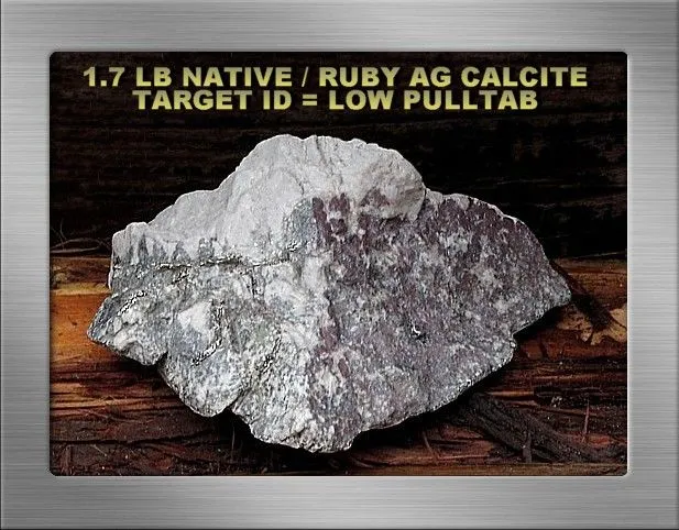

The photo above depicts an attractive native-ruby silver specimen found at the abandoned mining camp shown below during the early part of the autumn prospecting season. Many pounds of beautiful native silver have been found in this particular area, including fine examples of the deep ruby silver pyrargyrite embedded in creamy-white calcite or in a dolomite host. In fact the first season that Infinium was employed in silver country netted in excess of 18 lbs of ruby silver ores in close association with native silver. These doubtless constituted an inadvertently misgraded deposit in the waste tailings disposal areaā¦ within the view offered by this photo.

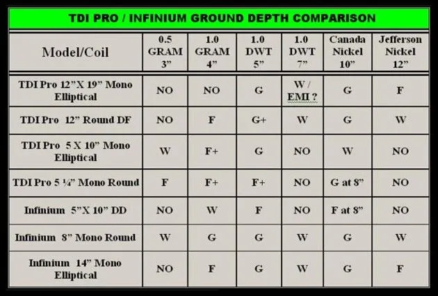

Infinium & TDI Pro Depth Comparison
Operated at bare thresholds the TDI Pro is a noticeably deeperseeking and more sensitive unit. As noted above, the Garrett Infiniumās depth / sensitivity is vastly improved by adjusting the threshold control up to 6ish or slightly more and adjusting headphone volume to preference. With this adjustment to Infinium there is little or no difference between these units regarding depth / sensitivity over a variety of target sizes buried at variable depths in my testplot. There is some variability between different types and sizes of coils of course. We see that large coils tend to be deeperseeking on larger targets and less sensitive to shallower small stuff and vice-versa for small coils. Mono coils are deeperseeking compared to similar size DD coils in this moderately tough ground.
Now letās look at some low conductive target responses presented in the chart below. As noted above, the majority of silver ores are low conductive. Keep in mind these depths do not represent the full capability of these units. Using solid lead ānuggetsā instead of gold or silver nuggets, the fact that theyāre freshly buried, and rather severe local EMI conditions all contrive to reduce detection depth compared to silver or gold nuggets naturally settled in the field. But they do work just fine for relative side-by-side depth comparisons between these units.
For this comparison, Infinium threshold is set slightly above six (6), employs zero discrimination, with the ground balance control locked after ground-balancing the unit. The TDI Pro is manually ground-balanced at just below GB9, set to near maximum gain, with a 10-usec-pulse delay and a bare threshold. The chart designations indicate Weak, Fair, and Good signal responses.
I tend to compare the 8ā Infinium round mono to the TDI designed Razorback 5 X 10ā elliptical mono, and the Infinium 10ā X 14ā elliptical mono to the TDI Pro 12ā DF round stock coil because these are comparable sizes. I think we can agree that the results are fairly close, the variances are likely due to the coils tested. I see no significant advantage either way on these low conductive targets, but certainly the Infinium 8ā round mono searchcoil performs very well over the entire target size / depth range.
Both these units have been used extensively in the field for several autumn prospecting seasons. Operating as described, Iāve not noticed any discernable depth difference between them.
To place the chart into a sensible perspective, we should note that there are a number of factors that affect depth results at any given time or place. These factors include magnetic susceptible iron minerals, disturbed or undisturbed soil conditions, soil moisture, electromagnetic (EMI) interference, physical / chemical characteristics of a target, detector settings, operator skill and so forth. Itās not unusual to encounter situations where a deep target in the test plot can easily be had one week, while the following week it is difficult to acquire a decent signal from the same target. The only factors that could have changed are soil moisture and EMI levels.
Size and shape notwithstanding, nugget structure or ācharacterā is a decisive factor as to whether Infinium will or not respond to smaller nuggets. The one-gram piece noted above is compact and solid. I have many similar size nuggets with more ācharacterā that respond poorly to Infinium by comparison. Some will barely signal even when rubbed on the coil. I suspect many such nuggets go unnoticed by PI users, except those using recent offering from Minelab such as the SDC 2300 PI unit.

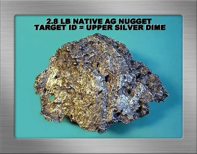

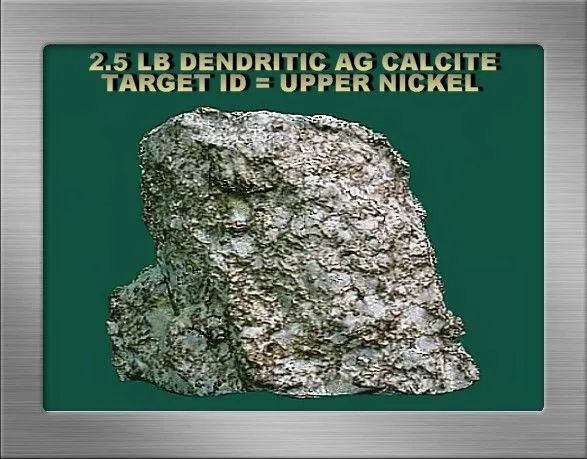

The photo below depicts a large dendritic 2Ā½ lb native silver specimen. It responds with a solid hi-lo signal in zero discrimination, and a much quieter hi-lo signal in reverse discrimination. It was recovered at armās length with my shoulder reaching into the hole. This was tough digging in a difficult concrete-like rock matrix that might have gone on much longer were it not for using my new Garrett Propointer. The Propointer is a fairly tough, water-resistant tool ideally sensitive for effectively pinpointing multiple targets in the same hole and no worries about rough treatment.

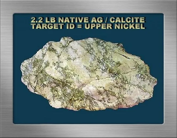

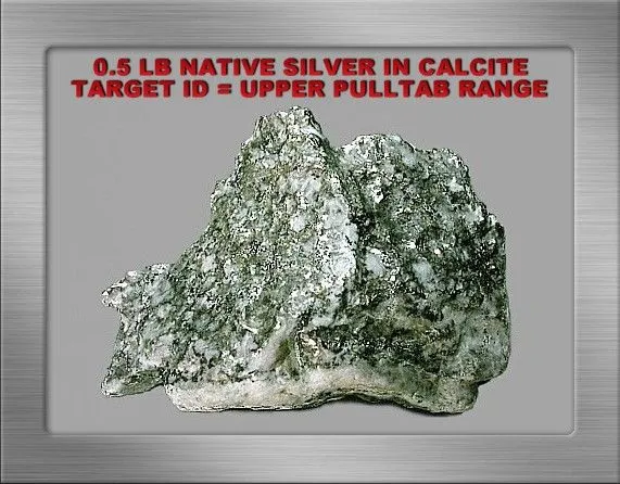

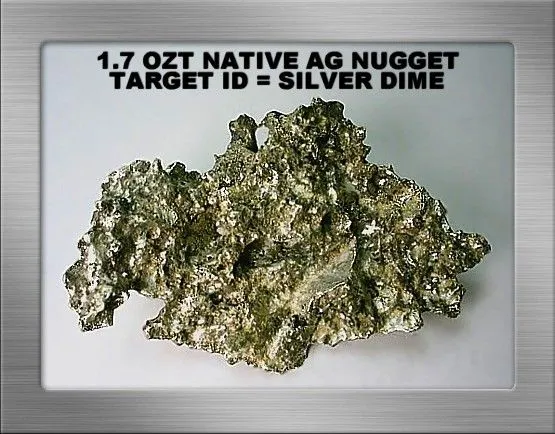

The attractive silver nugget illustrated in the photo below fits into the āconductive windowā just described. It responds with a lo-hi signal in zero discrimination and a weak hi-lo signal in reverse discrimination. It also combines good ācharacterā with very high conductivity, a unique and rare find.
Zero discrimination hi-lo signals, hi-lo signals that disappear in reverse discrimination, and reverse discrimination hi-lo signals must all be dug to avoid losing good targets. If you have good reason to think there are desirable targets beyond the silver dime range, then you must dig reverse discrimination lo-hi signals. There are instances where you must use some judgement, and it would be foolish to ignore broad weak signals that indicate a large target at depth. Always remember that adjacent high conductive iron trash could very well influence the weak signal produced, and that no target ID tone system is infallible. But in trashy areas, weigh that consideration against the likelihood that you will expend considerable effort digging high conductive iron junk reverse discrimination lo-hi signals, when you could have been covering far more ground digging more likely signals that produce hi-lo signals in both zero and reverse discrimination. To reiterateā¦ high conductive silver that produces a lo-hi reverse discrimination signal is extremely rare, so weigh your options carefully in the field to achieve consistent productive results.

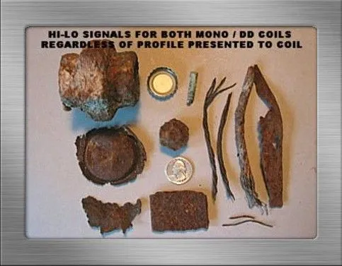

We have described target classification above as an overview. Lets look at some iron photos and relate these types of iron junk to the signals they produce. Keep in mind that silver ores do not change signals in the field. They are in a fixed position, are not both magnetic and conductive like iron, and therefore normally respond uniformly regardless of how the coil is manipulated. Low conductive iron as described in this report, fits into the same category. It gives a hi-lo signal in both zero or reverse discrimination regardless of profile to the coil. Low conductive iron is difficult to separate from low conductive silver for reasons described above, so I wonāt repeat them again here.
Examples of low conductive iron junk as depicted in the photo below include rusty small iron tidbits, small flat, thin sheet iron and tin, twisted or braided iron wire of any diameter, small nuts and small nut and bolt combos, small Ā¼ inch iron plate, rusted jar lids and so forth. Very short twisted iron cables of any diameter are a real nuisance because the length is insufficient to identify them as can be done on longer pieces. All these give hi-lo signals in zero and reverse discrimination.

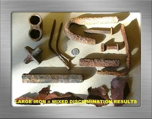

Some large high conductive iron encountered in the field exists exclusively above the silver dime conductivity level and is definitively identified by Infiniumās tones. It yields lo-hi signals in zero and reverse discrimination regardless of profile to the coil. There is a tendency for very large, thick nails or spikes in the 8ā to 12ā range, flat / thick and / or elongated plate iron, and larger drill bits to fit into this category.
The vast majority of high conductive iron is solid, elongated iron of nearly any size from nails to drill bit rods and even larger bars and broken implements. Most of these give a lo-hi signal along the length but produce a hi-lo signal when the coil is swept across their width in both zero and reverse discrimination. The photo below gives you a bit of an idea about the variety of typical, larger iron that is commonly encountered in mining country. The three pieces along the bottom are low conductive, thin pieces of sheet iron. The remaining examples in the photo are high conductive iron.
The Infinium mono coils improve iron identification reliability over the DD coils. Some lo-hi reverse discrimination iron signals on the mono coils will respond as hi-lo signals on the DD coils. Some elongated iron will signal entirely as hi-lo signals with the DD in reverse discrimination. How much is the difference? The DD coils misidentify about 15% of my tested iron samples. But these tests do not represent proportions encountered in the field, so that figure is an estimate only. The mono coils have handled all highly magnetic susceptible substrates here quite well, the 14ā mono is lighter than the 14ā DD, the mono coils are deeperseeking and are more sensitive to small targets than DD coils. And as noted, the mono coils are more effective iron discriminators than the DD coils. Unless ground minerals require using the DD coils, I strongly suggest sticking with the mono coils for these advantageous reasons.

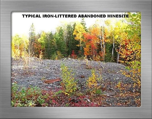

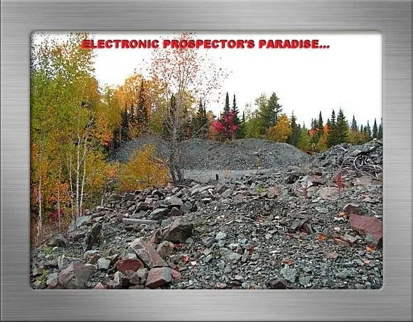

Have a look at the photo below. This scene was not set-up in any way. It was mere happenstance that I was there and snapped a photo on the chance that it might come in handy later. Look at the visible large iron. What we donāt see are the countless rusty nails, bolts and nuts, washers, wire and so forth that abound mostly on the surface. A good deal more iron lurks immediately beneath the surface. An operator has to scout around to find a spot clear of iron to ground balance a larger size coil at this site.
This area was searched with the large and smaller mono elliptical coils but it was pretty much a wasted effort. While the smaller 5āX 10ā DD coil does not generate similar depth results, it does better at navigating in-and-around abundant iron junk. As an alternative try using a suitable VLF unit at trashy sites. An MXT or F75 using a DD coil and / or a smaller coil will produce results in these conditions. It is better to find some silver than to walk away from a site frustrated with no silver.

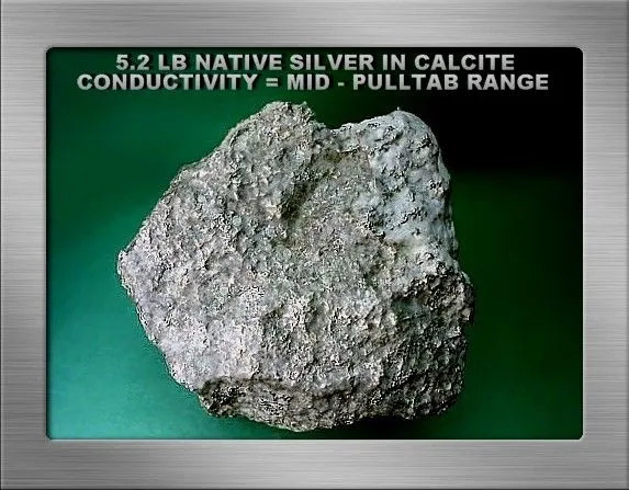

The photo below depicts a solidly structured native silver nugget found many years ago. Itās an excellent example of silver at the silver dime conductive level that gives a lo-hi tone in zero discrimination and a fairly strong hi-lo signal in reverse discrimination due to its high conductivity, large size, and solid structure.

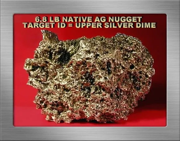

Below is a fine example of such big, deep silver in the form of an exquisitely crystalline native silver specimen found this past autumn with Infinium. I am almost certain it was swept with my VLF unit the previous year, notwithstanding countless others over several decades. But Infinium, equipped with a 14ā elliptical mono coil, responded to it with a quiet but unmistakable hi-lo signal. This is an especially valuable prize found at shoulder-in-the-hole depth.

ļ± Some high conductive lo-hi tones in zero discrimination will change over to become low conductive hi-lo tones in reverse discrimination. These include both iron and desirable non-ferrous targets. Dig all hi-lo tones in reverse discrimination to avoid losing good silver.
ļ± Use some judgement about digging broad, weak reverse discrimination lo-hi signals. Such silver is extremely rare, but you may wish to investigate such signals in less trashy areas.
There are always conditions in the field that may dictate utilizing the Infiniumās discrimination or tone feature in a different manner. We know that in reverse discrimination all zero discrimination lo-hi tone targets, ferrous and non-ferrous, within a range bordered by fringe zinc penny up to and including silver dime conductive levels will change tone to become hi-lo tone signals. High conductive iron is far more plentiful than high conductive silver in this limited range. To avoid digging this iron in trashy sites, you may prefer to stick with zero discrimination tones only. The trade-off is the rather low odds of ignoring a very high conductive piece of silver. This strategy frees up a lot of time to cover a lot more ground. Reverse discrimination hi-lo signals should otherwise be dug, and especially should not be ignored in gold country.
Summary
The Infinium identifies high and low conductives conveniently without involved manipulation of the controls to identify some high conductive iron. At zero discrimination high conductives give a lo-hi signal and low conductives give a hi-lo signal. Infinium automatically performs this task and does so to its detection depth limit. But it should be noted that at its depth threshold, it will occasionally default to a hi-lo signal. At least this ensures the target will be investigatedā¦ in several instances as digging reduced the coil to target distance, the hi-lo signal changed over to a lo-hi signalā¦ accurately identifying large high conductive iron. As previously noted, invoking reverse discrimination definitively identifies a good portion of high conductive iron when employed in a prospecting context. And letās reiterate that if you are willing to forego an infrequent silver piece above fringe zinc penny conductive level, all high conductive iron can be identified by means of the zero discrimination lo-hi tones.
There are many areas in mining country where there is an abundance of what might be described as āVLF background noiseā. This noise is the result of spurious ground signals from whatever mineralizations and targets that are present at various depths. Non-conductive ferromagnetic hotrocks, small low conductive pyrrhotite, iron trash, and remnants of other electrically conductive ores such as safflorite, cobaltite, skutterudite, arsenopyrite, niccolite, copper sulfides and other minerals associated with epithermal deposits. Amidst these undesirable signals exist randomly scattered silver nuggets and ores at variable depths.
VLF operators tend to ignore much of the spurious noise that survives even small iron discrimination settings while intent on locating ādiscreteā signals. In quieter ground such signals might be investigated, but in extremely busy ground they are mostly ignored. It just isn't worth the time and effort to investigate broken or ticky signals.
Infiniumās pulse induction electromagnetic field penetrates deeply and occasionally locks on to some of those indistinguishable VLF noises, generating an unmistakable ādiscreteā hi-lo or lo-hi signal. Some of those signals are unwanted, but some are large, deep or otherwise handsome silver. This capability represents Infiniumās best performance feature since it directly resulted in finding big deep silver.
Infiniumās second most prominent feature was its ability to segregate considerable iron that has plagued my VLF units as ādiggableā signals for many years. Four-inch rail spikes and five-inch long drill-bit rods are a particular nuisance to VLF units when located at depth, but Infinium easily identified these by their tone ID signals. I did not mind digging the hi-lo iron not identified by Infinium, because a good portion would have been misidentified by my VLF units requiring at least partial investigation anyway.
Adjusting the discrimination control is convenient when using a hipmount configuration, but after a week or so the coil cable connection to the unit body became stressed to the point of generating constant false signals. This necessitated mounting the electronics package under the armcuff to eliminate the cable stress. It became instantly inconvenient to adjust this control. I suggest Garrett consider mounting an āiron checkā button right on the handle for operator convenience.
There should be some additional stem length behind the elbow to attach the electronics package further back on the stem to improve overall balance. Its present configuration, mounted next to the handle, is very weight-forward and feels terribly heavyā¦ a ridiculously unnecessary strain on the arm and shoulder.
Finally, I suggest a complete solid stem that hobbyists expect with any detector purchase, rather than the present scheme that involves attaching two stem pieces that result in a flimsy, disjointed stem āwiggleā. Most hobbyists do not use the Infinium for scuba diving, so please eliminate this nonsense by offering an additional scuba short-stem as an accessory. Too many hobbyists including me have felt it necessary to purchase aftermarket stems to replace the original inappropriate product. These are likely more expensive ($165 delivered to the door) than the cost Garrett would pass on to customers for providing a properly designed stem.
That said, the Garrett Infinium is without doubt the most effective instrument Iāve used in 25 years for this application. Its depth performance on typical size native silver ores is often more deeperseeking than some hobbyists might wish to dig into difficult rocky substrates. As described earlier in the report Infinium excels at separating silver and other conductive ores from some high conductive iron at good depthsā¦ a real time and work saver!!! Thankyou to everyone for taking the time to get through this revised report.
