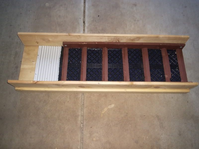

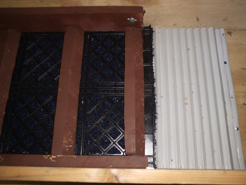

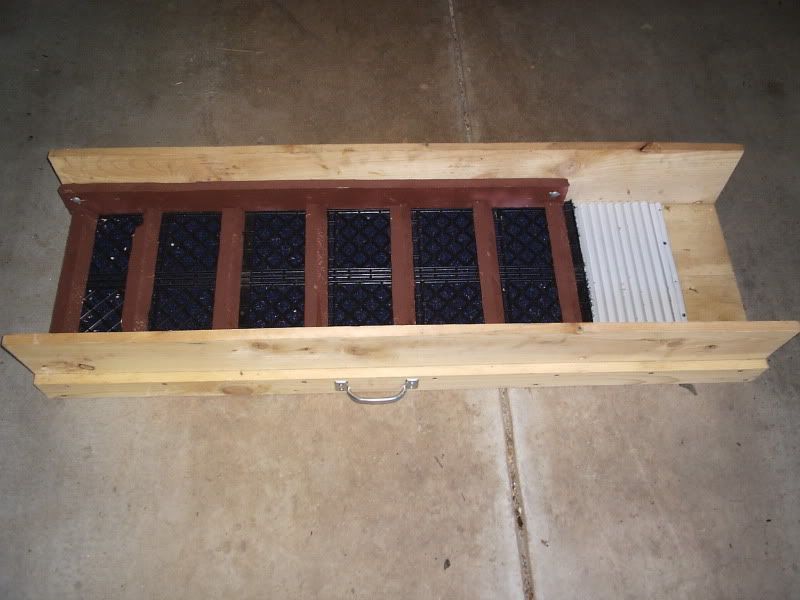

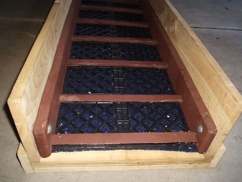

The box was built at my father-in-laws woodshop in about 1/2 hour.
The Hungarian riffles are made from a couple bookshelves my mom gave to me to hang in our kids room. They were uglier than $#!% so they went to a better cause.
The "expanded plastic" is from the base of those 2 liter soda bottle carriers you see in stores. I got like 4 of them for free from the gas station down the road.
The carpeting is some miners moss given too me by a guy at work because there was a 3 inch tear in it. The nugget catcher is the plastic sides from a window AC unit.
:icon_sunny:

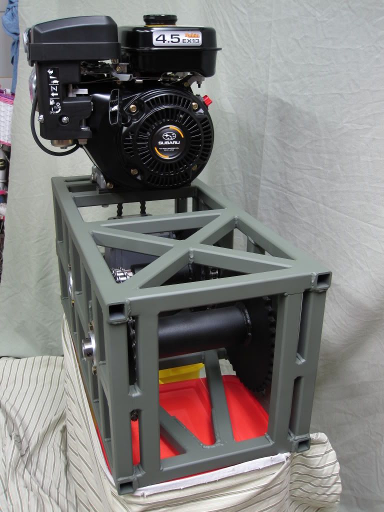

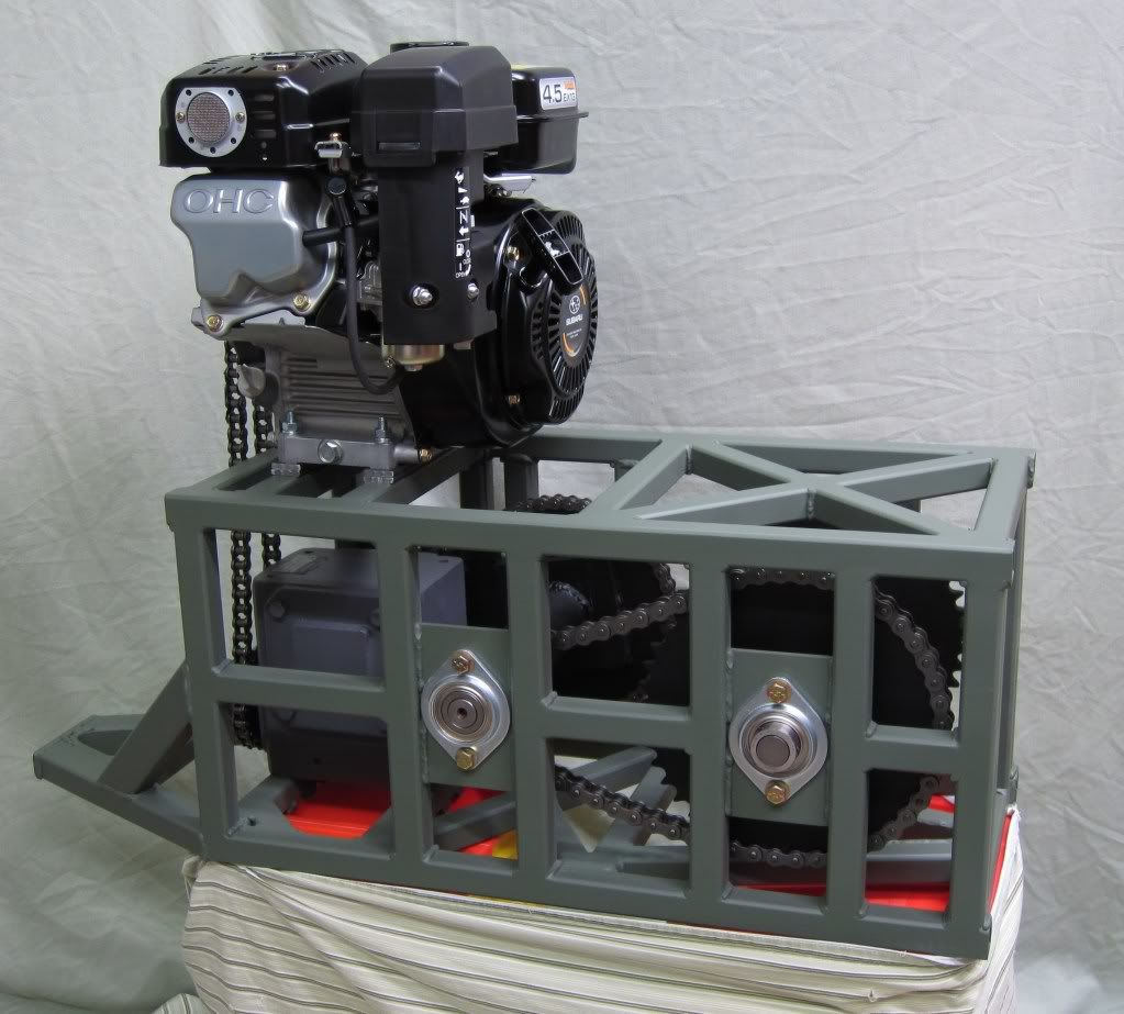

Here is my "Winch Build 2010"
I am hoping that I can use them someday whilst dredging on my claims here, not looking so good at the moment here in Cal for this.
Building another winch as we speak. I am not sure why as I read the proposed regulations. :(
Not sure what is wrong with the pictures or the camera, might be the fluorescent lighting, the winch is actually a OD Huey Green ???

Gravel Hog, What is your total gear reduction there. Looks like enough to move some pretty good size rocks. :thumbsup:
Plenty of Torque. :thumbsup: Better have it mounted, chained, etc to something big and solid.
Are you talking to me? :laughing9:
Got it all covered! Been doing it for over 30 years and learned from a master, good ol' dad. :thumbsup:
