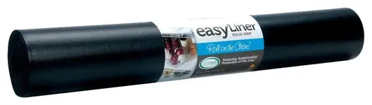

I was wondering. If you used the black mat from walmart on the miller table, and assuming i made it from wood, would i need to sand the wood to be super smooth and then paint it? Or could i just glue the mat down?
I assume we would still have to seal the wood and what not so it doesn't get water logged. But if i could get away with out sanding the wood so much (referencing DizzyDiggers post on making one, where he sanded the wood, paint and everything in between.) It might be more doable here rather then having him make one (unless he really wants to and then it would be fine.) We just don't have a sander here that i could use.
Is this the mat you guys were referring to? http://www.amazon.com/Duck-280211-N...tra-Fresh/dp/B00C2LMJPY/?tag=treasurenet01-20
Duck Brand easy linder Ultra Fresh.webp If it is, amazon has it cheaper then my local walmart and comes as a prime item so i would get free 2 day shipping.
Lokiie, hadn't got around to writing a reply to your PM, but this is
exactly what I was going to suggest. A basic table with the matting
is very easy to make, and having to sand depends on the base material
you're covering with the matting.
I've had great success building them using the pre-made melamine shelves
you can buy at any store like Lowes or Home Depot. I know that Lowes
will cut it to size for you, but they might charge you $1 for making the
cut...or, if you have a saw at home you can make the end cut yourself.
Shop Real Organized 73-in x 12-in White Shelf Board at Lowes.com
I would cut it into 2, 30" pieces and save the 12" for another project.
You will also need:
1 ea. 6' 1x3 (straight)
1 ea. 2' 1x4
1 can 3M Super 77 (or Super 90) adhesive
Approx 25 2" quality screws (stainless if they're not too expensive)
1 can Shellac or Spar Urethane sealer
1 small tube silicone sealer
1 roll of the shelf liner you gave a link to
Once the shelf has been cut to length, you'll need:
A drill motor and 1/8" bit, plus a Phillips screw tip for driving screws.
A couple sheets of 150 grit sandpaper to clean up any runs or drips
in the sealer.
That's all you need to make a good quality table, minus the
water feed, valve, pump, etc.
You'll want to seal the wood well, so start off with several coats
of sealer on all sides and edges of the melamine shelf. If you spray
several thin coats on there shouldn't be drips or runs.
Once the sealer has cured for a day, you're ready to attach the
shelf liner material to the board. This is best done in a well
ventilated area, and you want to make sure to get it right
the first time, as those adhesives don't allow much working time.
What I do is lay the material out face down on a work table
(not the kitchen table!), and spray it first, and then
the panel. Wait a few seconds and, then lay the material over
the panel, making sure the material is taught, and no bubbles
or wrinkled areas. Then, lay the panel down with the top surface
on the bottom, and place a few heavy objects on top to allow
them to seal up well.
Then you can cut the 1x3 into 30" lengths for the sides. If they're
short, at all, you want to make sure you have a flush edge with feed
end of the panel. Drill all of the screw holes, and before installing
the side board, lay a bead of silicone along the entire edge of the
shelf panel. This will insure there's no leaks in the sides.
Next, cut the 1x4 and mount it on the "feed" end of the panel. Again,
lay a bead of silicone on all edges before installing. If you didn't make
the side pieces flush with the feed end it will be difficult to get it to seal.
That should be enough to get ya started, and next we'll work on a
cost effecting valve, pump and spray bar.

Mike the only thing I can add to this process is to cut the mat to fit, lay the mat into the box as its going to be used. Next fold the mat in half but do not crease the mat where its folded. Spray the mat and then spray the surface. Wait a until the 77 becomes tacky then work the mat into place starting at the crease and working to the end. Repeat this process for the other end. Doing it this way you can not screw up in not getting the mat flat and square to the edges. Because your spraying the mat in place the the box needs to be taped off (Blue Masking Tape) on the inside walls and the top edge off the so that 77 is not sprayed onto these surfaces.
This is the method I use to lay foam and playing surfaces on poker tables that I build and the method I use to lay my rubber mat into my box. Works like a charm without the hassles of getting everything lined up and having the two surfaces come in contact with each other without the mat aligned up.
Now I understand how ya do that process.
I typically cut the mat to be 1" long on all edges, then
once the adhesive's dried well I use a razor knife
to trim the edges, and then add the side pieces.
Next one I'll give your method a try..:icon_thumright:
