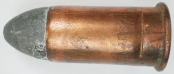

Here's a photo of a Benet-primed (1868-1882) casing for the postwar .58 Alin-conversion Springfield Rifle.
  • cartridge_POSTWAR_Benet-primer_58-caliber_1866-Allin-Martin-conversion-Springfield_photobyIan...webp
