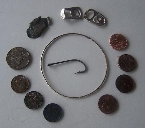

Today is gloomy and gray outside. It has tried to rain several times but did I stay home. NOPE It is the last day of the month and I wanted one more try at getting another ring. Did I get it? NOPE I didn't get much of anything at all. I did get a bangle bracelet & 59 cents. My total rings for this month was 22. Not all are good but whoopee anyway!

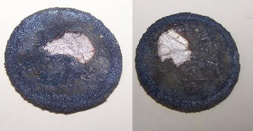

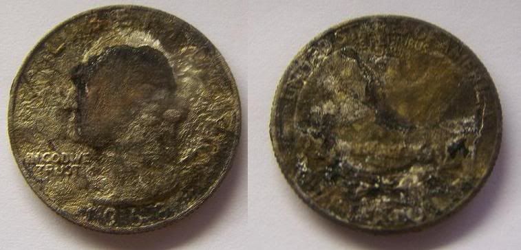

OK no matter. I just went home and put together the electolysis gadget and tried my hand at cleaning that coin I found yesterday. It was the worst corroded coin I've ever found and I was sure that it was going to be something good. According to the instructions it said to leave the coin in the solution about 15 minutes but that it would start bubbling right away. It did and the water was turning black pretty quick. After the 15 minutes I took it out and a lot of the corrosion had come off but not near as much as I thought it would. So I tried it again for another 15 minutes with clean solution. It still did not come out as good as I thought it would. I've seen coins that others have done and they looked great. Well I can definitely tell what it is now. It is a 1968 quarter. So nothing real spectacular. Perhaps I didn't do it right but it was the first time I've tried to do this so maybe I'll get better.
After 2 times in the solution

Hi, I'm not sure from the pictures, but it looks like you might have the polarity of the wires wrong.
Remember, the electrode goes to the side of the container using the positive (+) (anode) alligator clip. The coin to be cleaned goes to the jaws of the negative (-) (cathode) alligator clip. If the wires are reversed, you'll end up depositing (plating) the coin with the metal from the electrode as it dissolves from use.
Also, stay away from stainless steel. It's listed on numerous websites as safe and it may seem that the electrodes don't dissolve, but Chromium is being dissolved into the water and it's highly toxic!
If you must do this, "MAKE SURE" to do it in a "WELL VENTILATED" area as the fumes are not safe to breathe and can be explosive too!!!
Just thought this info might help!
