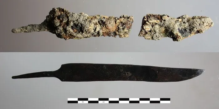

From a total mess into an nice medieval knife, ready for museums display.

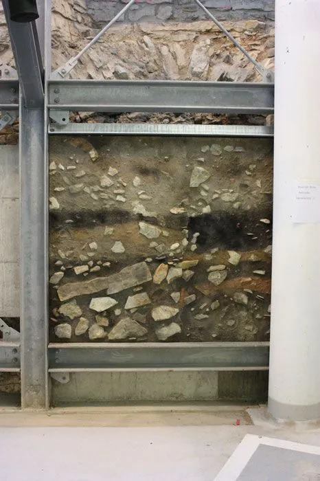

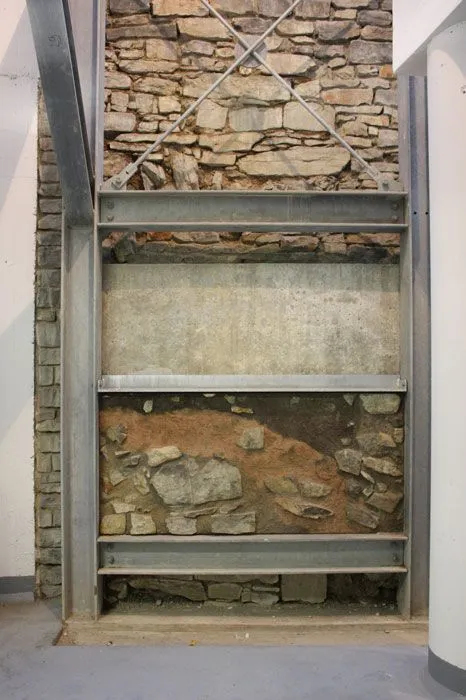

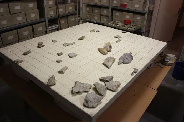

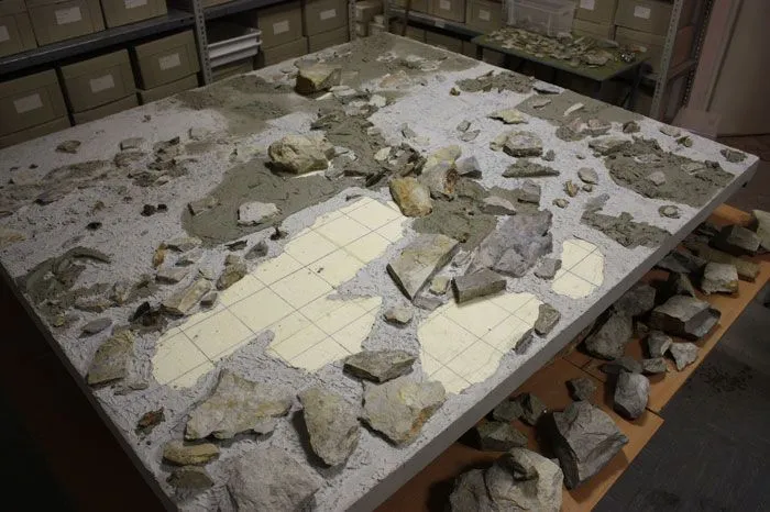

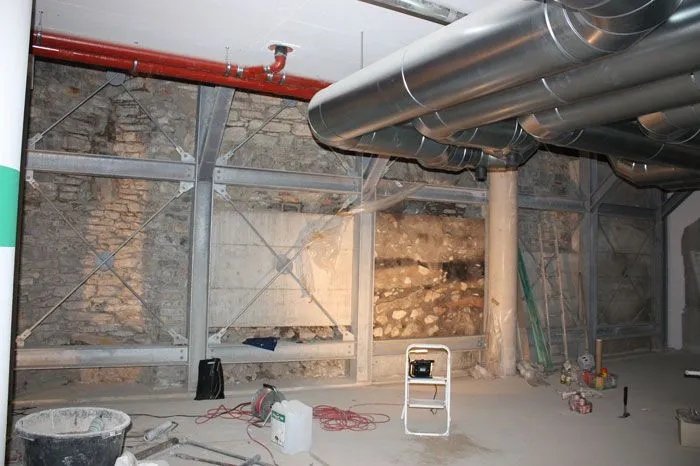

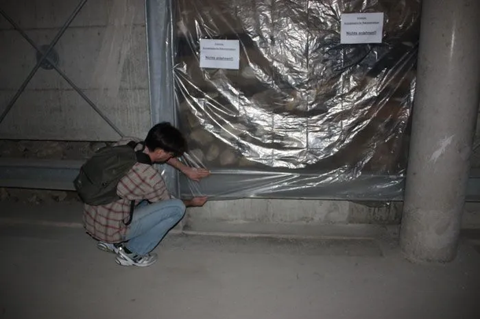

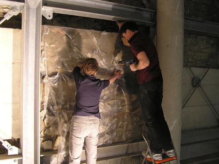

After a huge excavation we had over many years on a 10.000 square meter areal, there was build a new building with an underground parking lot. Intact walls and interesting archeological profiles wanted to be visible.
Unfortunately ground water started to destroy the original profiles with all the nice layers of soil from different ages. So we made photogrammetric pics and reconstructed this profiles out of the original stones and soil from this layers.

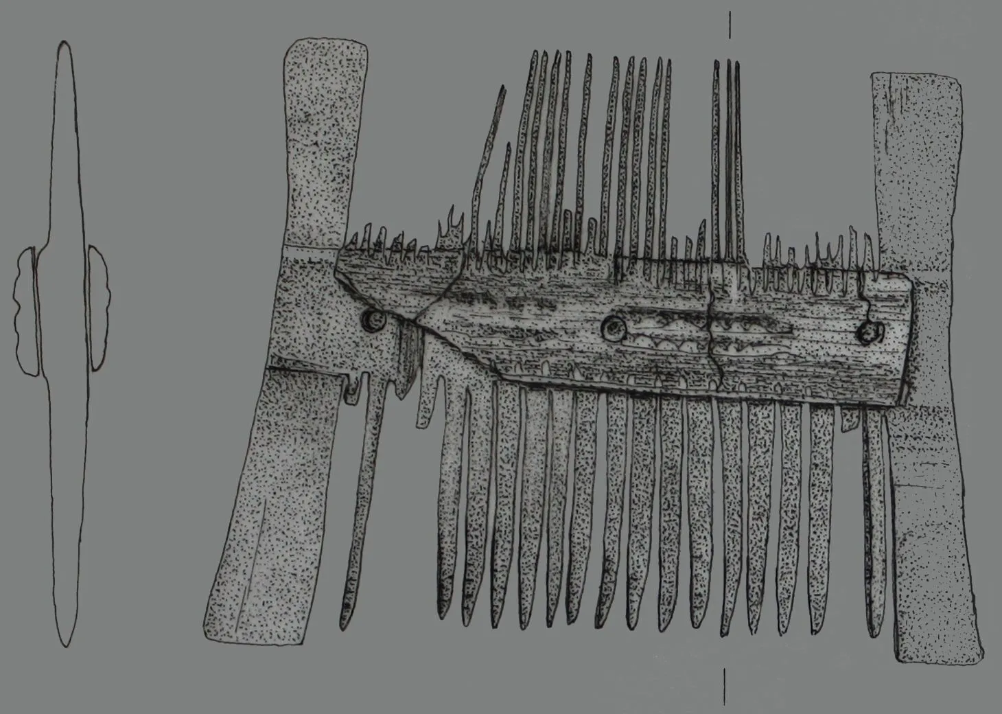

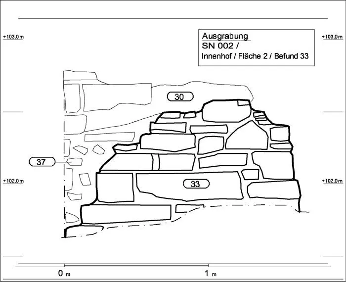

Archeological paintings/sketches for publications

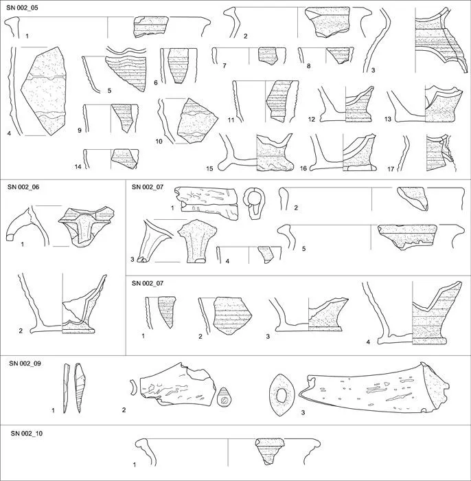

Digitize sketches

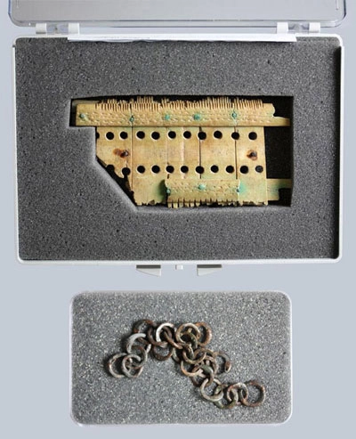

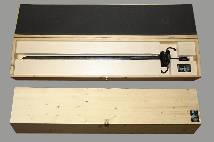

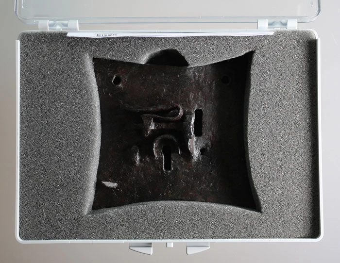

Making boxes for museum storage of restored objects

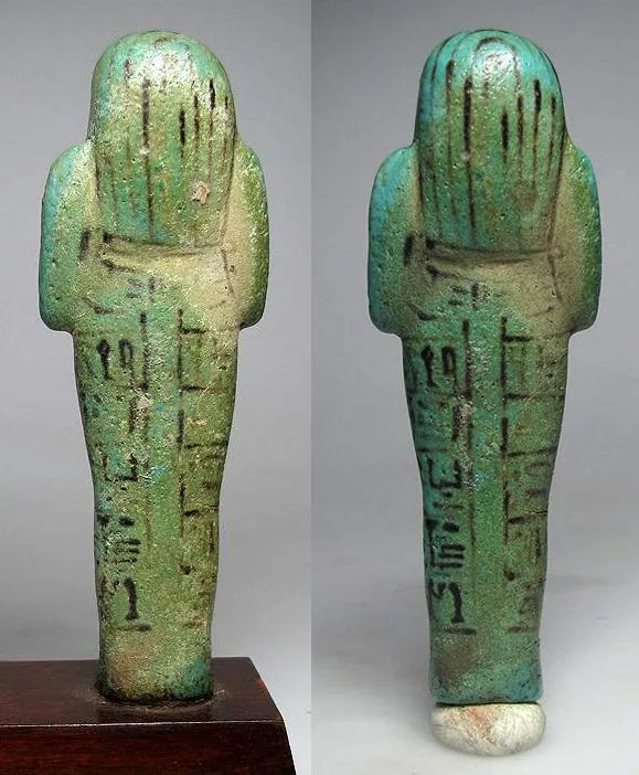

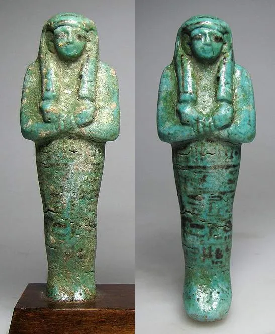

Cleaning and bringing back the faded color of a 3000 years shabti of king Psusennes.
His cartouches and inscription is now visible.

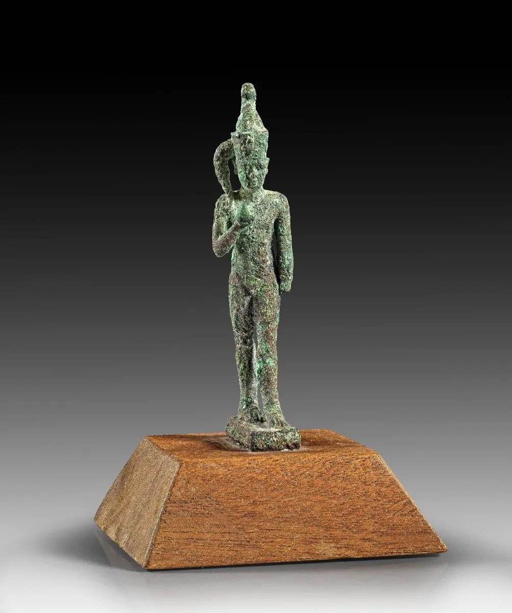

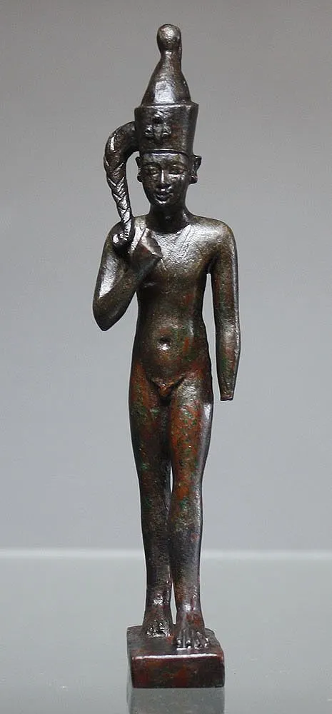

Restored bronze figure of the God Horus (Harpocrates) with Gold inlaid eyes.

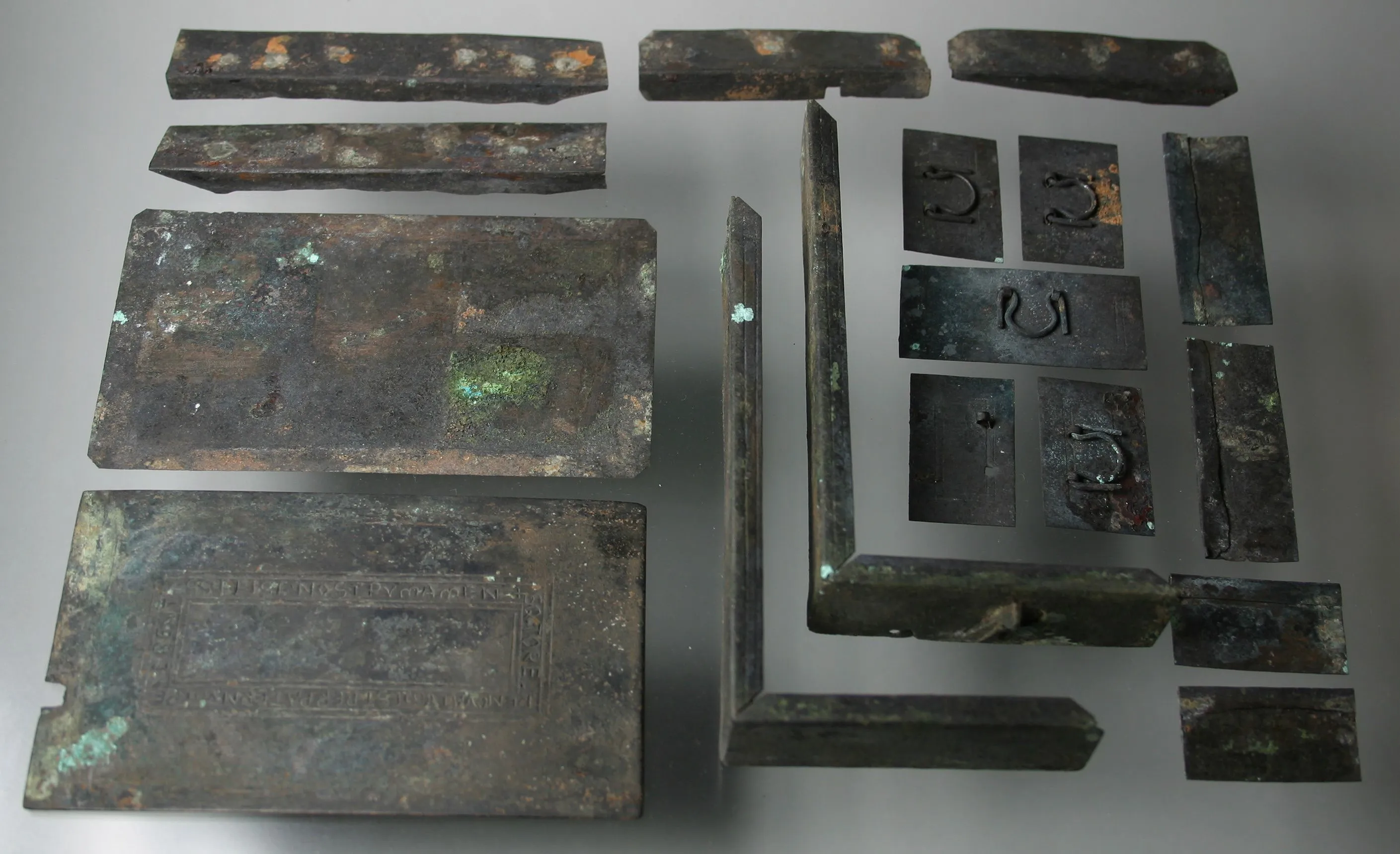

CATASTROPHE !! :laughing7: :laughing7: :laughing7: :hello2: :headbang:
Look what´s happen after one more night in Acetone. Fallen complete apart... :laughing7:
Most of this parts was fixed with glue and some other fragments cracked new because the salt.
Anyway, now I can clean the cracks with air abrasion from salt and Akaganeit and clean it from in- and outside until small areas of metal appears to put all pieces together in a steel net and in electrolysis.
Before this happen I let them for a while in alkaline solution. This makes it easier to wash out all bad stuff in electrolysis.
On the second pic you can see what nice surface it well get later. The alkaline solution made it possible to scratch this area clean just with a scalpel.
You can see on the thickness of some parts that there is a layer of rust mixed with gun powder which is up to half an inch thick. All this stuff must be cleaned away for doing a proper electrolysis.
This MESS :laughing7: is almost finished! Wife just makes some retouches in this moment. Pics of the result will follow!!

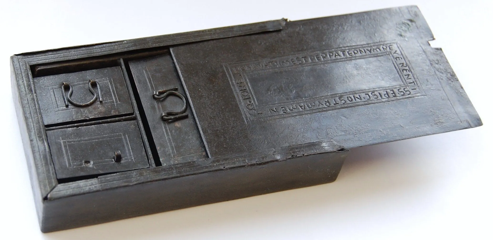

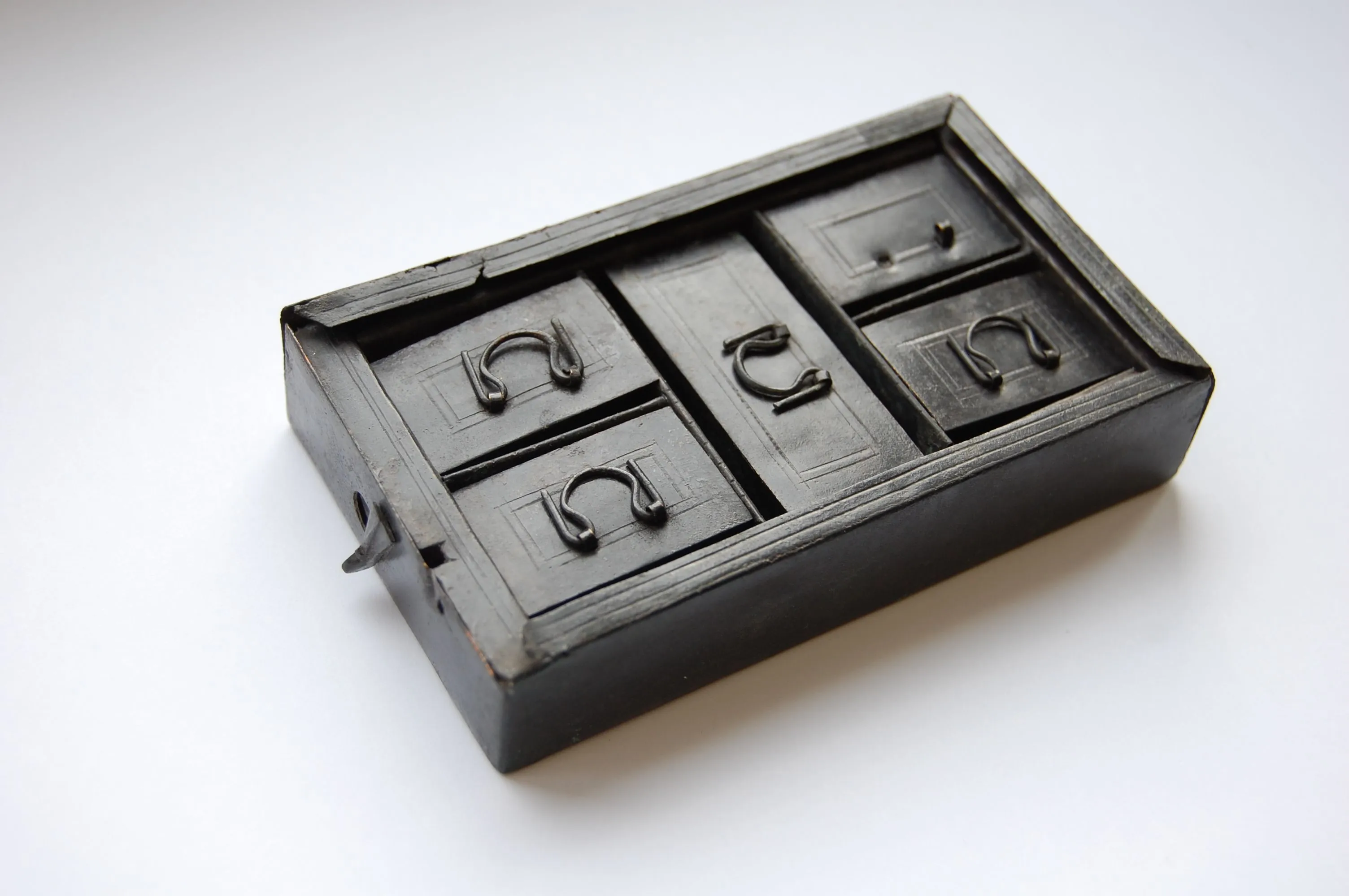

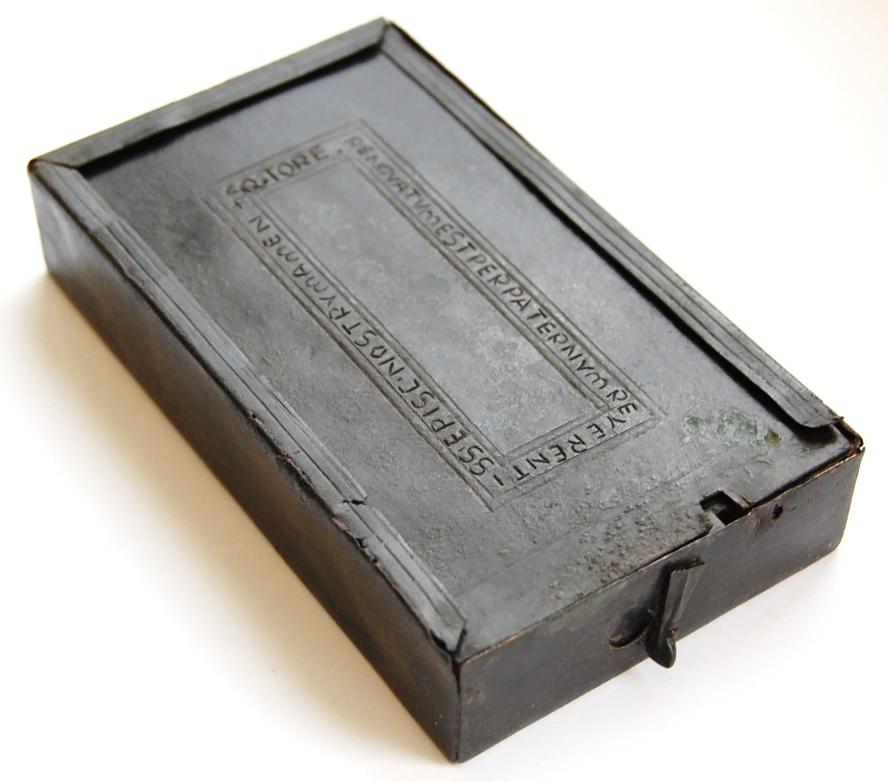

Restoration and reconstruction of a Roman inscribed medicine box from an Doctor.

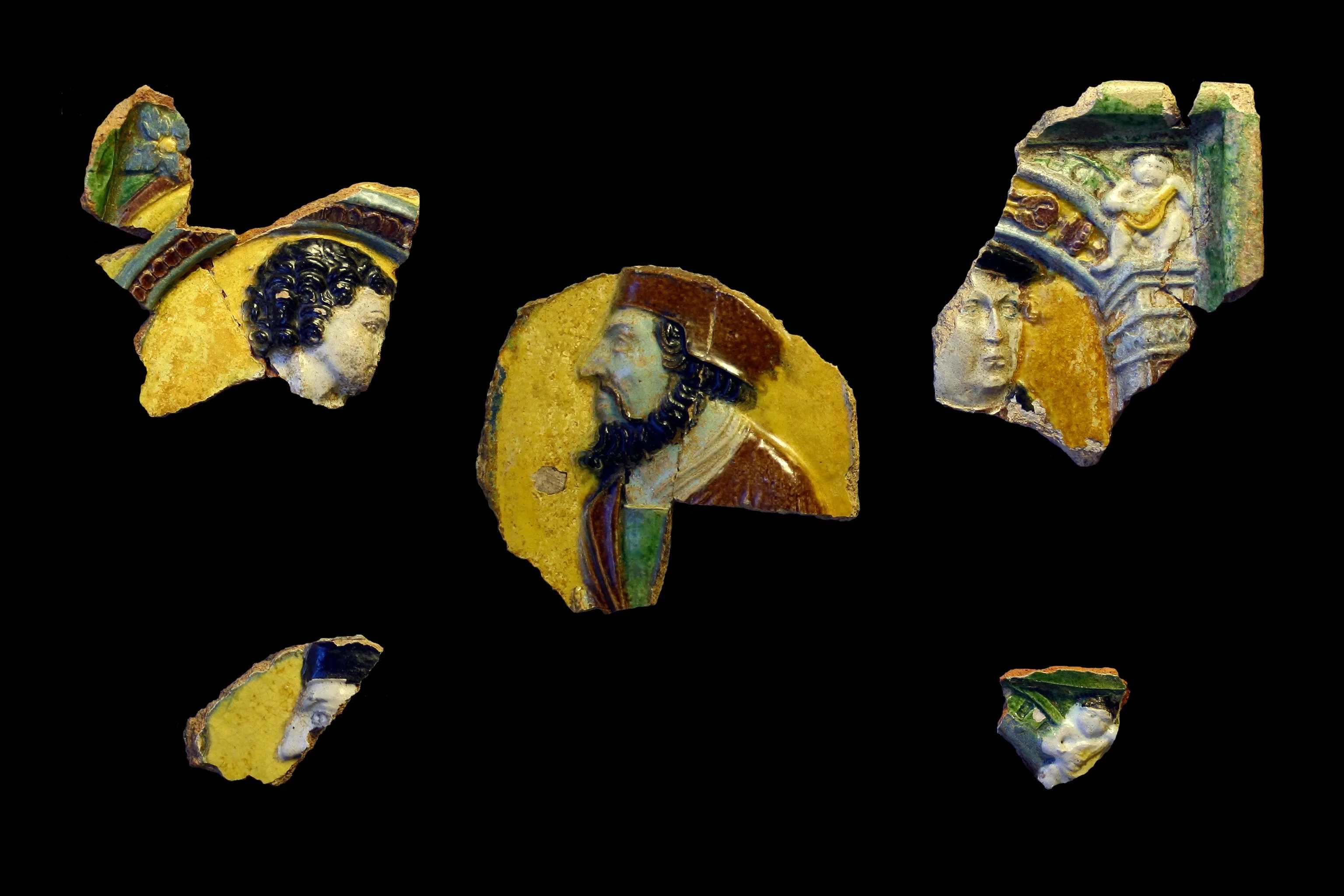

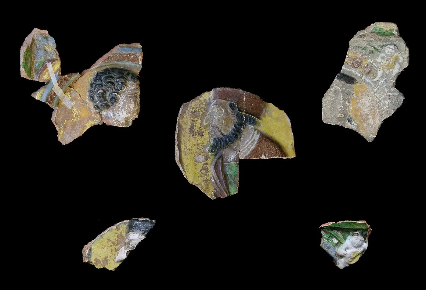

Cleaning, preservation and bringing back the color of 17th century oven tiles with depictions of Reformers like Martin Luther etc.

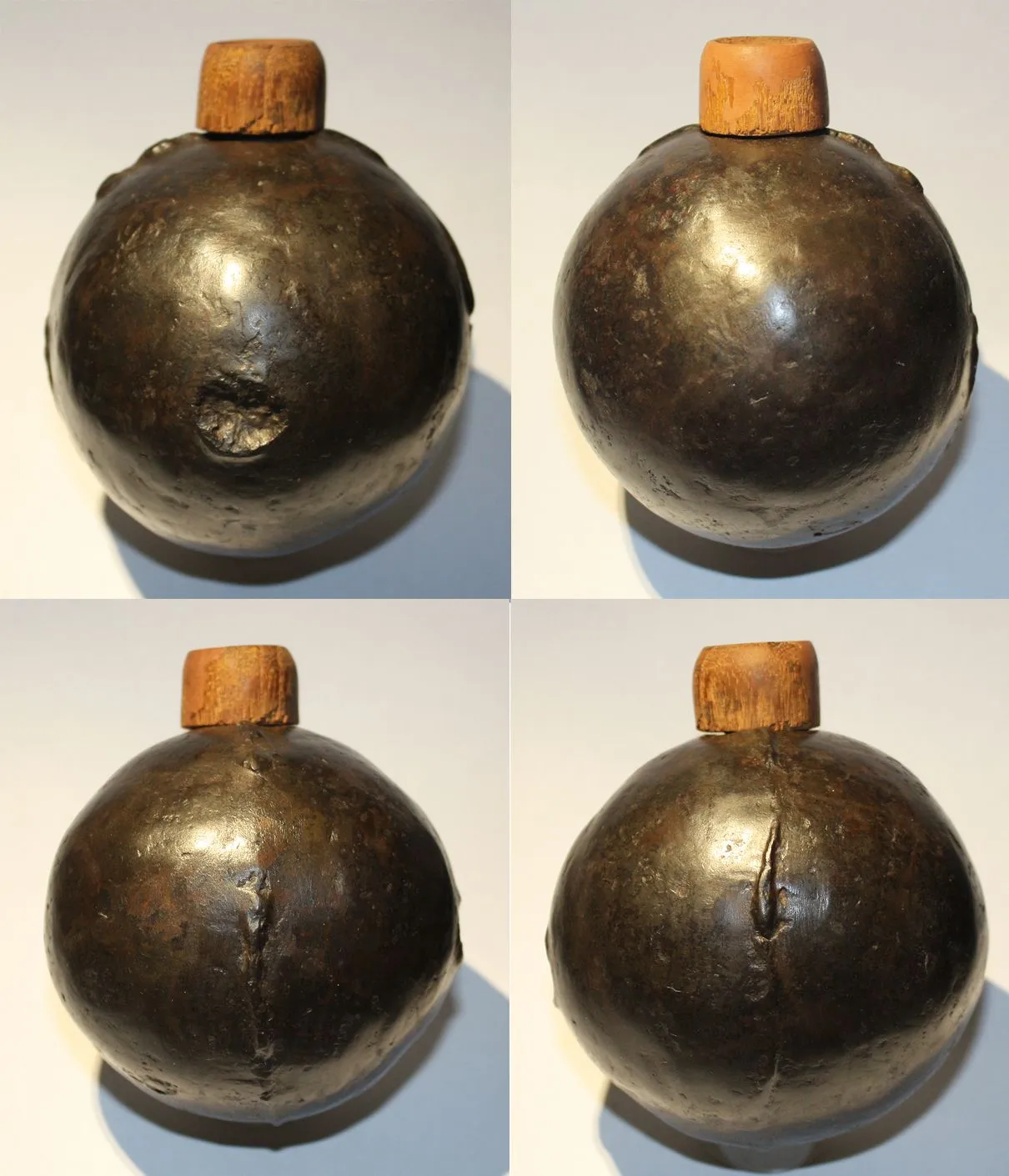

OK, here is the finished shipwreck grenade from the Princess Maria
I observed the piece now in unpreserved condition for 2 years and it is absolutely stable. All salts etc. was washed out completely and it will stay in this condition. Ready to go in a collection!
