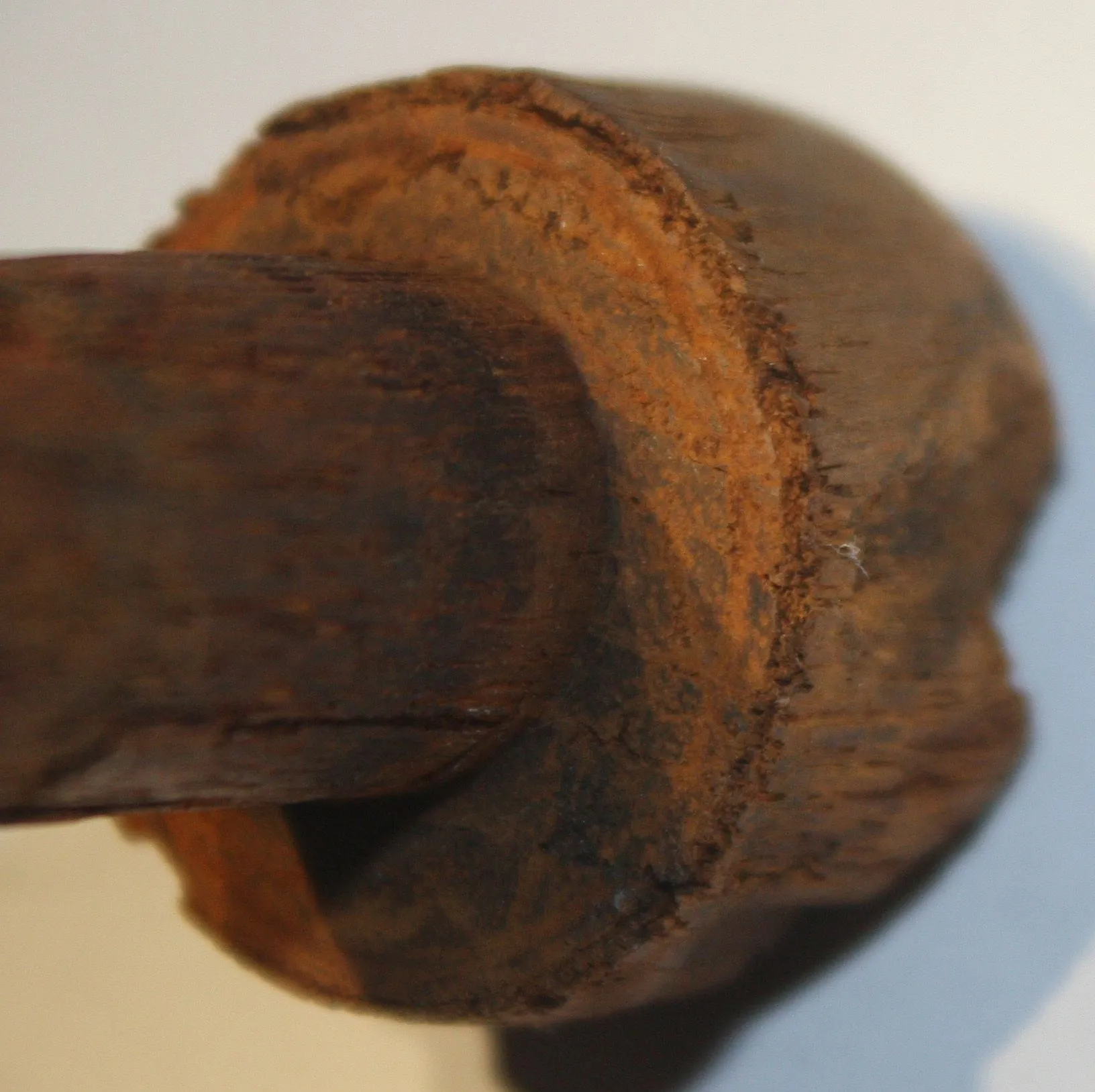

can someone tell from this pic what kind of wood it is?
What a Find! And, what a job - restoring a BOMB...!
Take care, and thanks for sharing...!

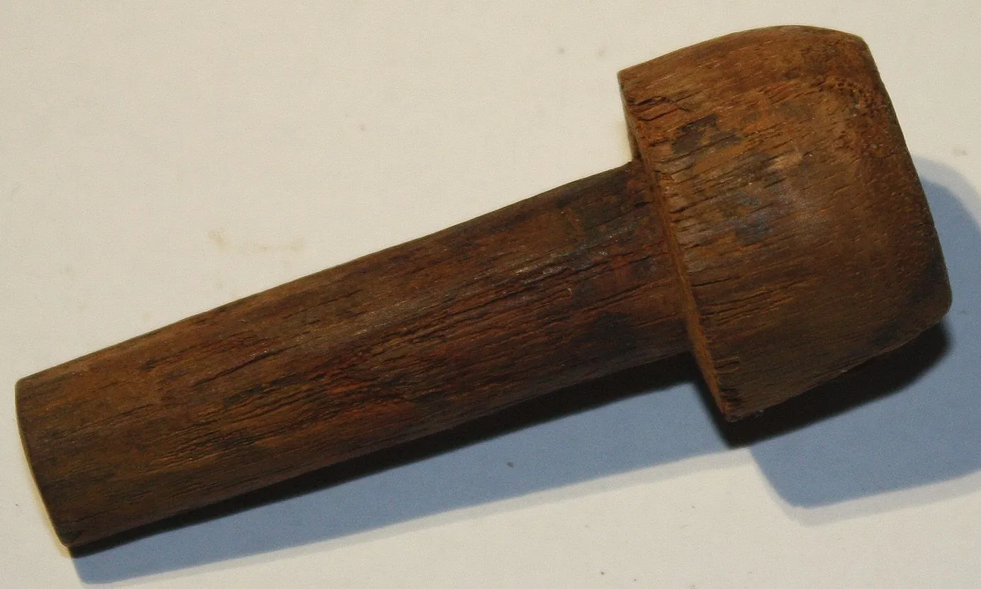

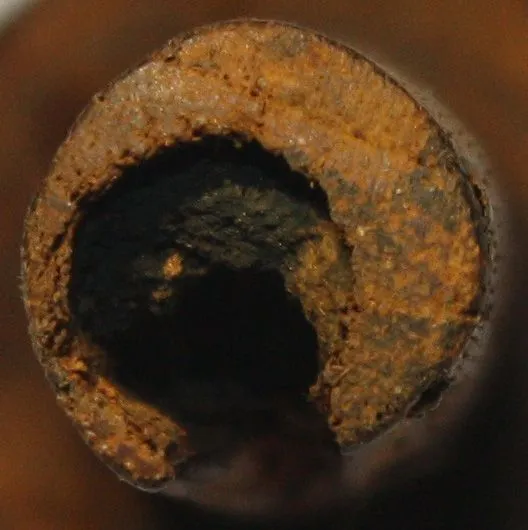

They are usually made from local available wood. What country do you live in?

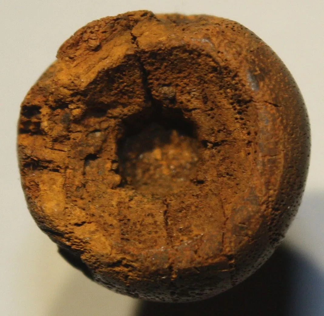

Tom, can you post a picture of the fat end with the hole? I can't tell much from the side view.
Sure! Comes a little later Buddy!
Germany but the Grenade is from Dutch East India vessel Princess Maria, sunk 1686 at the Islands of Scilly UK
I was going to say it looks like teak but that wouldn't be possible for a vessel that has never been to the East Indies. It's also well preserved for a 330 year old grenade like teak would be.
I usually go to the local wood carvers, especially the ones that make bowls...they seem to be very keen on wood types. Good Luck!

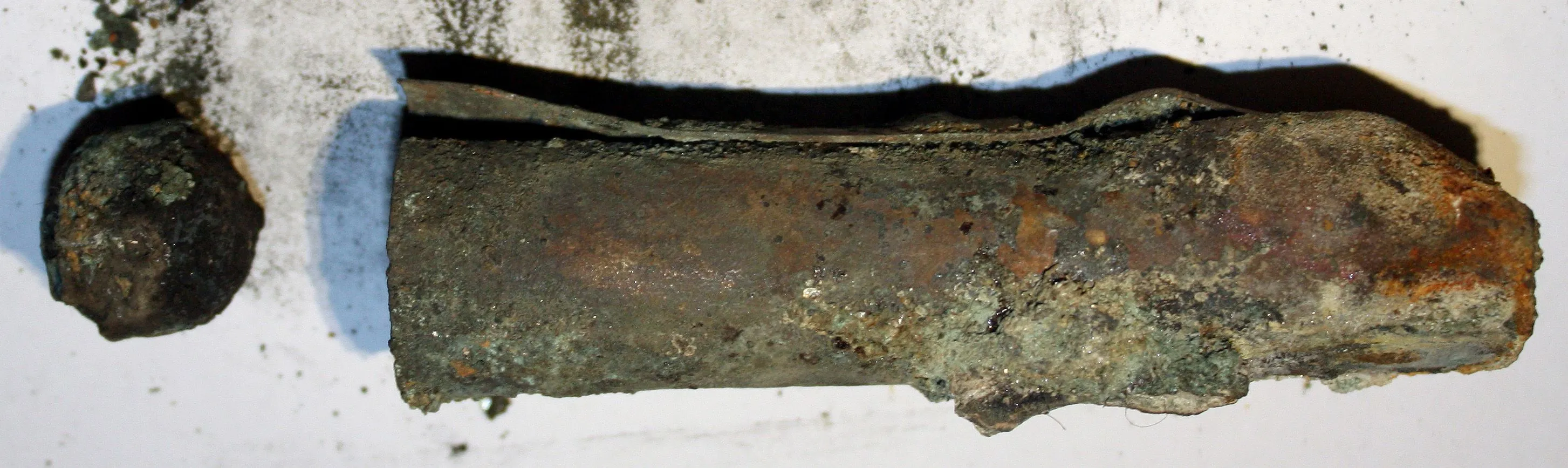

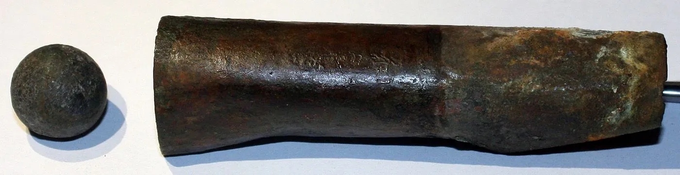

A quick photo of one particular cleaned and preserved tube with musket ball from inside. Shining comes from flashlight.
Some of the tubes are smashed and the thinner ones lost some material at the bottom. But this is later not visible because I have to make a reconstruction of the inside to put the tubes back in place.
The entire inside with the tubes is a conglomerate of sand, small stones and corrosion of the bronze parts which has to get apart...
I try to take this out and care at first on the leather!

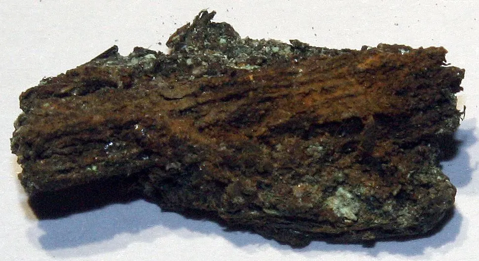

Just found inside of the encrustation traces of wood! So there was n´t only a construction of this thin metal inside but also a wooden core which holds the tubes! Now I have to figure out how it has looked with the thin outside layer of metal which is complete smashed.
Have to get anything apart and bent back the thin metal to figure out the original shape and compare it with the original size of intact leather case.... will be a lot of puzzling :BangHead: :tongue3:
Just luck that some parts of the leather has still the original high and that the bottom with rounded sides is still intact, so I have the original size at all.

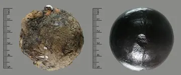

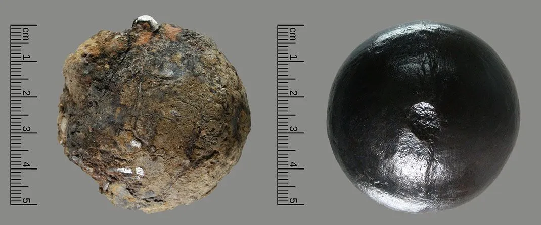

An other smaller Cannon Ball I restored a while ago.

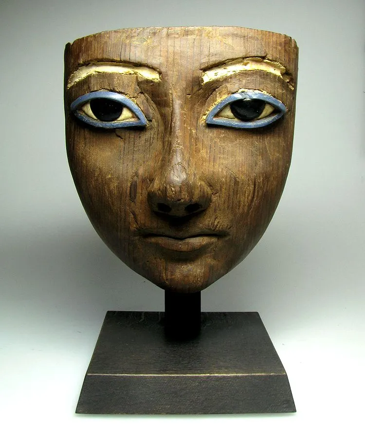

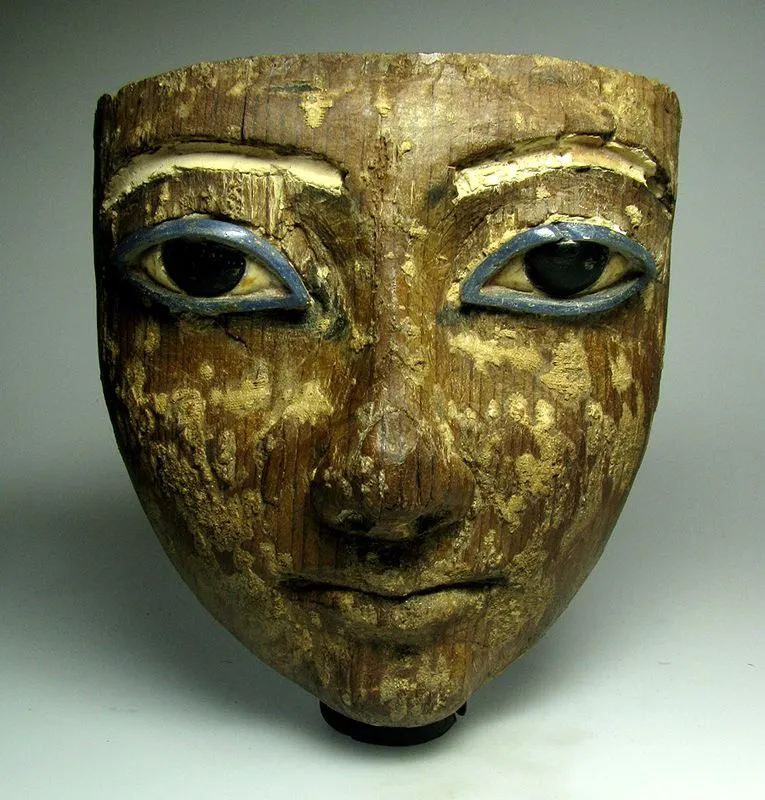

Cleaning of an 18 dynasty royal or noble sarcophagus mask. All this traces of stucco and the stuff Termites leaves after eating wood was too disturbing and hiding a real piece of art. So the owner wanted this stuff to be removed, so the piece will show its fantastic facial impressions.

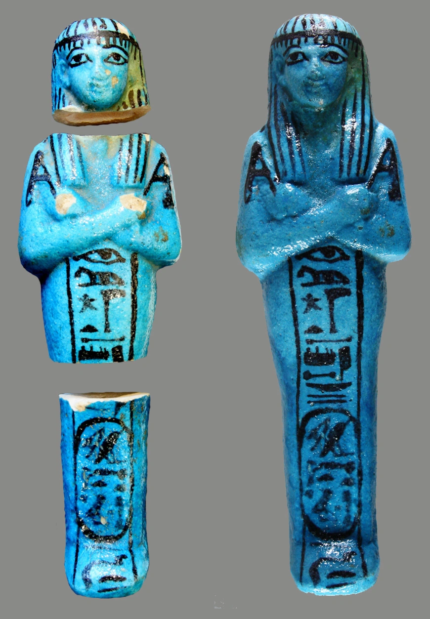

Restoration of a queens Ushabti figure. All her shabtis that was found before 1900 was broken in many parts and completely mixed up when they gone to museums and collections. Also this 3 parts was from 3 different figures and was put together in an early restoration to one piece. Unfortunately it was made very ugly and they also has grind down all parts to make them more or less "fit". The photo shows this pieces after removing the old glue and how I put is together, reconstructed the missing areas and painted it include the missing glyphs. The restoration is not recognizable now.

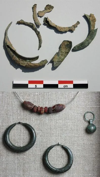

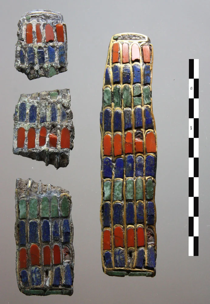

This was a work for an exhibition. Bronze age inventory of a woman's grave.
The earrings was thin like paper and a complete mess as you can see. The archeologist thought they was not to rescue.
Pic below shows the inventory include this earrings in the exhibition :laughing7:

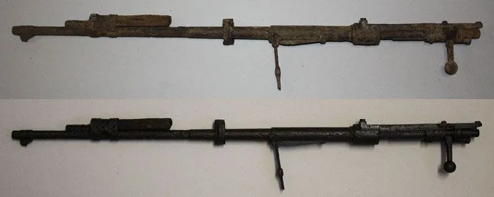

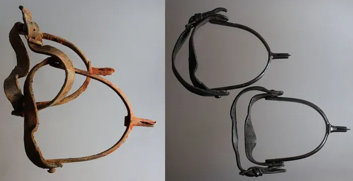

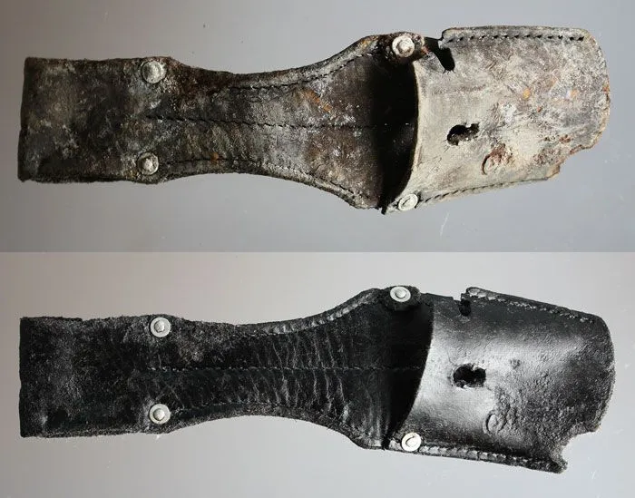

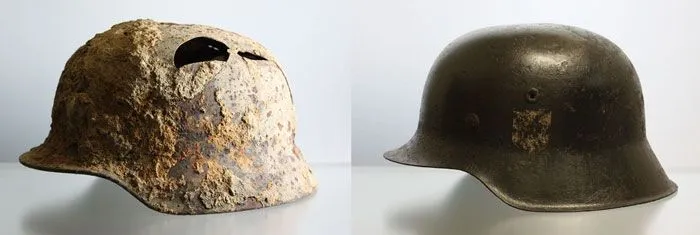

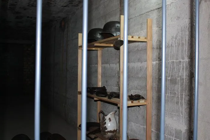

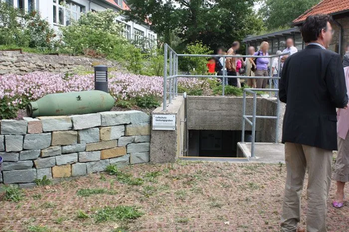

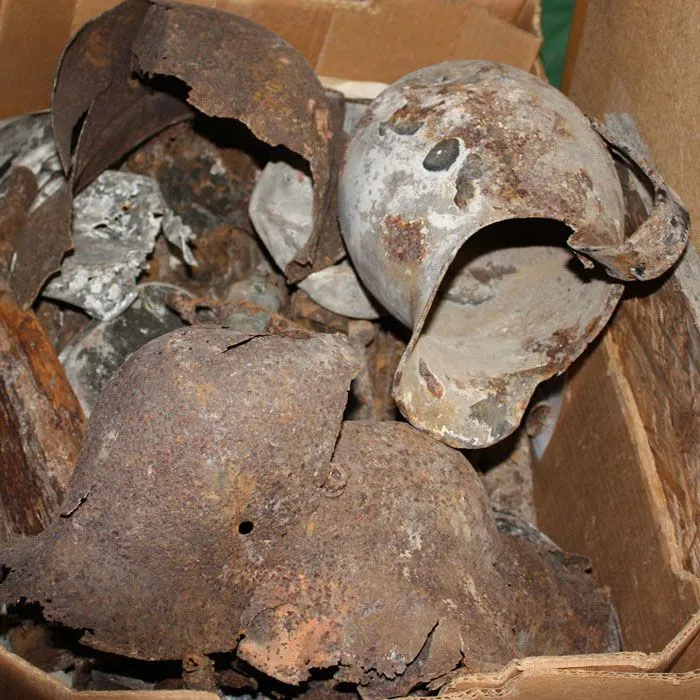

World War 2 material for a museum. They found on an excavation on the museums areal an intact WWII bunker with a lot of stuff inside which they want to make visible for the public.

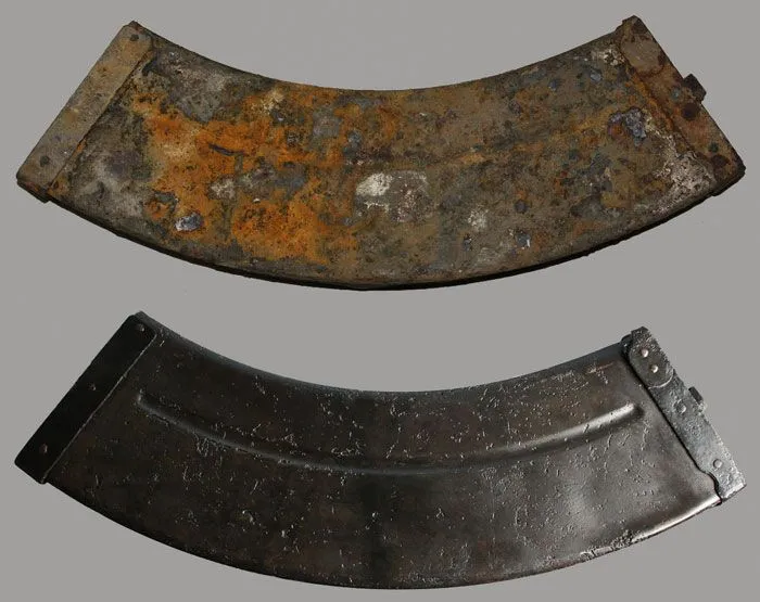

I restored most of the stuff include guns, mags and many other different stuff.
View attachment 1700138 1.webp 3.webp 4.webp 5.webp 6.webp 7.webp 8.webp 9.webp 10.webp
