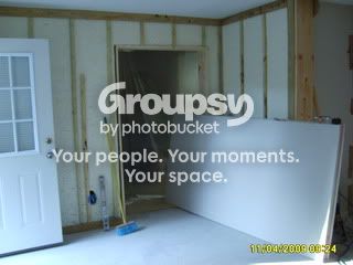

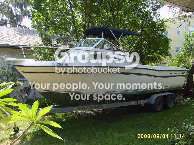

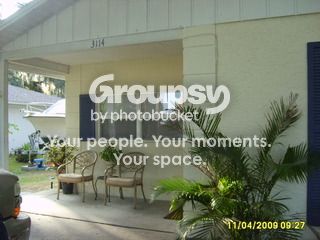

Belive it or not I still haven't had a chance to learn my new Coinstrike yet! Too many other projects are getting in the way. I have a boat restoration I've been doing for the past year and am just finishing up on turning my carport into a dineing room. Just not enough hours in the day!! Here's couple of pics. If your interested in boats and my boat restoration you can view it at this link: http://forums.iboats.com/showthread.php?t=275835
