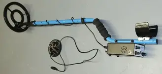

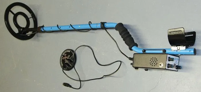

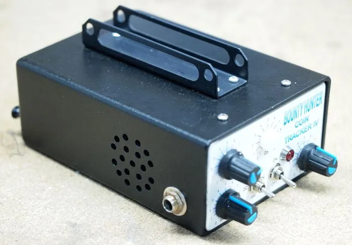

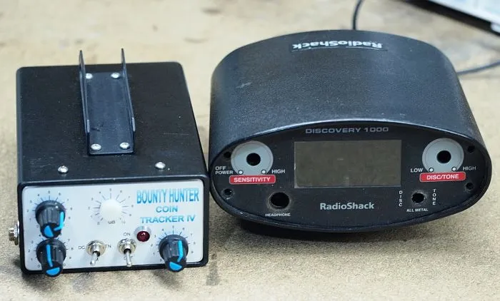

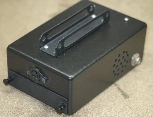

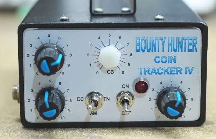

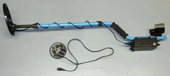

Here's a remastered Tracker IV I built up for my wife. Lightweight, balances perfectly, new housing, 3 pc. s-handle--lower HB rod, middle and upper from A Detectorpro Wader.
Replaced all pots, addeded on/off toggle switch, added volume control, kept the low battery LED and dumped the meter. Left the manual ground balance option for a later date.
May not be deep, goes deep enough for my wife.
Beautiful mod there. Very impressive and I can tell you took your time and did a really nice job.
Bounty Hunter should take some tips from you. That thing would sell like hot cakes simply because you got rid of the "muffler on a stick" look and created something that actually looks cool. You could sell em' yourself in multiple, made to order colors.
All you need now is that ground balance an 11" DD coil (Fisher makes one that'll plug right into it). I'll bet that thing would be quite a capable machine. If you were to waterproof it and make it fully submersible, forget about it. I'd probably buy one from you.
