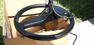

I was having a similar problem with sand getting inside my coil cover, I had read several post of what they had done, tie straps, tape, epoxy, truck bed liner spray. You name it and it probably has already been done once or twice.
I didn't want to go to the extreme just yet. I just sprayed my coil today with liquid tape. first coat, will put another on tomorrow and making my coil wire longer. Too short for waist mount usage. Im sure it will wear off but I like to experiment with different ideas. Makes this sport more fun. Might try the Goop or Epoxy next we shall see. Glad to hear your Excalibur is working fine now. I just got mine also, learning as I go, but everyone here has been so good about helping out and if you have a question I know someone will have the answer or they will point you in the right direction to find it. Happy Hunting never give up!coil.webpliquid tape.webp
