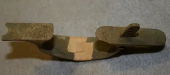

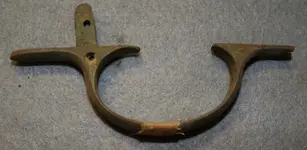

Charlie P is correct, as usual. It is definitely not from the civil war era (Model-1853) Enfield Rifle... because the trigger guard for those had an vertical attachment tab (shaped like a tall tombstone) on the top of its front end. The famous "Brown Bess" Enfield musket, which was the standard British Army musket from 1722 to 1838, had a similar vertical tab atop its front end. To see what I'm talking about, examine the photos below, which show a Model-1853 Enfield's trigger guard (the back end is broken off, like yours). I do not think yours had a tab which is broken off, because your photos apparently do not show a long narrow rectangular "break-off scar" where the tab would have been located. If such a scar is there but its not clear in your photos, let us know. If it's there, then it might indeed be an Enfield trigger guard.

In the first picture it looks to me like there has been a tab broken off. Look close, I see a rectangle in about the right spot. It appeared to me the hole
doesn't go all the way through because it's plugged with dirt. It's probably been bent so it looks like a pistol trigger guard. Looking at CharlieP's picture
the tab would not interfere with the ramrod, it appears to be at the very end of the ramrod hole. It would be entering the wood right behind the nipple,
which is right at the face of the breech plug.
its a broken and bent M1853 Enfield trigger guard. Like NHBandit noted above, this trigger guard has been discussed elsewhere on this forum.
