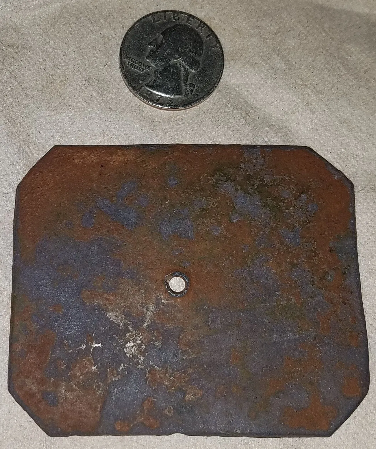

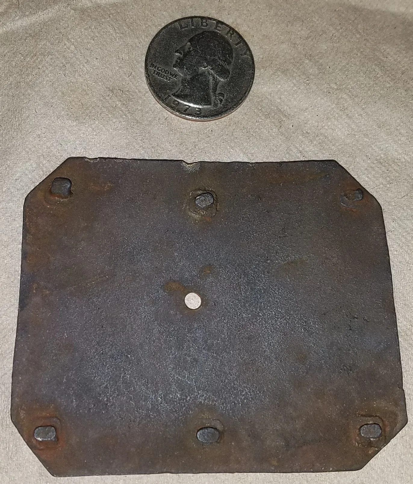

Ok, sorry, gonna breathe life into an old thread,,,,,,
Found this clipped plate on a recent hunt.
http://www.treasurenet.com/forums/today-s-finds/526218-1732-house-overflowing-history-involving-t-jefferson-b-franklin-m-lewis.html
I've read several posts about this now and wanted to see if there have ben any changes in opinions or info. Have any trunk plates been found that match ones that look like this with the 6 attachment points on the back? I cleaned it up a little better. You can see some of the brass showing through on one edge where something clipped it (prob my shovel) but even after cleaning it's still pretty grey. Is that just corrosion or was it silver plated?
Trunk PLate? Belt Buckle? Cartridge Box Plate?
Wondering if it could have been the back to something else. The hole in the center makes me think something was attached to the front of it. I saw another here somewhere with 2 holes in it I believe.
