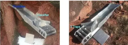

Anyone here actually used one of those UnderFlow Sluices from XgrumpyProspector?
I've watched several videos and am very impressed. I'll be going to Northern California this spring to do some prospecting and want to take the best equipment with me.
Thanks in advance for your honest opinion.
LarenC in Talent, OR
Ive seen the videos too and I think you would do just as good with a bazooka as it is based on the same type of principles. the guys on here talk highly of it that's for sure.
I've seen the video's also, and if I remember right you still have to classify with the Underflow. Being able to directly shovel into the Bazooka Gold Trap not only saved tons of time not having to classify, but it has saved so much wear and tear on my lower back. Plus, you can run two to three time more material in the BGT. So saving time, my lower back, and running more material makes slucing so much more fun.
...and more productive (more gold is always good!)
Hard to argue with logic, and these guys on here are highly experienced pros! As an experiment, I placed a large pan at the end of my drop riffle sluice last time I was home. I placed 3 large rocks in it and pointed the pan's riffles downstream. I classified nothing. After running 1 bucket thru, there were 8 flakes of gold in the pan. I shallowed the angle of the sluice and continued to run unclassified material. Never found another flake in the pan, but did quite well in the sluice! Ran a total of about 10 buckets 2/3 full unclassified

I purchased an UnderFlow sluice from grumpyprospector.com and can't say enough good things about it. I bought the high-banker model with water system. Where I'm digging, there are no nuggets.....just fine flour and micron gold. I classify down to 1/4" and run my material using a 1000 GPH bilge pump. I have a "y" splitter on the pump and run some of the 1000 GPH back to the recirculation tub through another hose so I'm not putting all the water pressure through the sluice box. If you run about 750 GPH, you will get great results. Re screen your material down to 3/16" and run at about 300 GPH and you will get all the real small stuff.......gold you can't see with your eyes unless you put it in all in a pile in you pan. I have tested this sluice many different ways at home and in the field and am always amazed by how small a particle of gold you can get with this device. No black sands to pan through......just use a sucker bottle to get the fines. They now make an Ultimate River Sluice using the same idea, but you can lay it in the creek and don't have to classify anything. A buddy bought one and we ran it in the creek behind his house. We took some Gold from my poke and counted the pieces. I spiked unclassified material with my Gold and we caught 100% of what we put in there plus extra gold that was in the material. It works just like the videos show on YouTube. They truly have the best sluices on the market. Several styles to choose from. I will be purchasing an Ultimate River Sluice from them for myself very soon. Thumbs up from me.
Nuttn' but copying over/under same same as dredges. Make your own as ez to do with expanded metal or punchplate,used'm for at least 35 years since I introduced o/u to dredges.You can go full coverage-but then you miss all nuggets bigger than your holes,half work pretty good or just over the first 2 sets a riffles to protect them fines-nuttn' to it-do it yourself-John

The UnderFlow is a little different than a regular O/U sluice. Their new Ultimate River Sluice has part of the O/U design in the first section after the slick plate. All the classified stuff goes through the "U" shaped traps and the unwanted stuff goes off the sides through a "V" shaped shovel design. There is also a water pressure release set of holes before the UnderFlow traps to let extra water pressure out of the sluice and not flush the traps. Still looking for someone who uses one of these before i purchase one to get some more feedback. I will post pics and a review once I get one in my hands.

This is a medium scale of the underflow river sluice. Includes one classifier that is interchangeable. Preferred size classifier incuded with purchase, the second and third classifiers are an additional charge (classifier size options 3/32", 1/8", 1/4") and three collection traps set at 1 1/2 inch. This is another great set up for all your precious metal recovery needs. This system is ran by the natural flow of water by placing the Underflow river sluice in the water current at a slight angle (the slickplate slightly higher 10-20 degrees). Start running material by putting rocks and dirt on the top of the slickplate. You will notice the unwanted material passing by the classifier and heavies going through the classifier, and processing through the adjustable underflow traps. Catching all gold, precious metals, and gemstones down to micron metals. This system is so efficient by controlling waterflow within the system and processing material at a very rapid pace!
This includes 14 inch common flat slickplate as shown, and the underflow sluice section (28 inches long by 8 inches wide) which includes three 1 1/2" traps, and interchangeable classifier (3/32", 1/8", 1/4"). Second and third classifier are not included.

Get a gold cube....... Far superior to the underflow sluice.
The underflow will not catch fine and micron gold. The underflows will wash it right out and since there is no matting between them just slick surface there is nothing to stop and hold the fine gold.
It is a very poor attempt at a design that Trev brought to attention .... The New Zealand beach box. Which by the way the gold cube got it's inspiration from.
And Underflow guy.... I think was a shill. Because the crap he spouted about this thing is BS. And yes, I have watched the video's.

I built an underflow sluice and i really needed to classify my material to catch all the gold. It makes a good cleanup sluice. I ended up using it in conjunction with some hungarian riffles placed after the U-shaped section.
