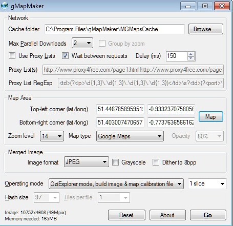

Gmap Maker, is a useful program to download, convert and calibrate maps from google,
here is it the main windows, just select the map area to create you own calibrated .map as Oziexplorer needs, click on 'map', draw using the mouse an rectangular area and select map type and zoom level, from 5-to-9 is good for me, then press 'go' button, and voila !

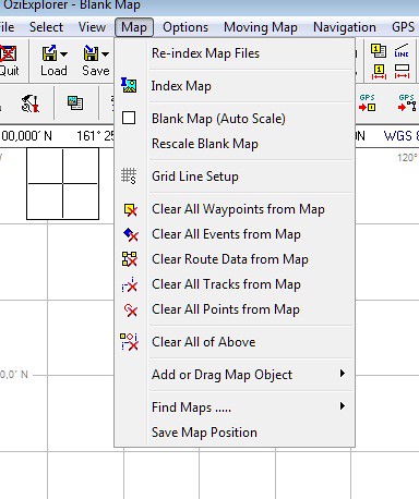

two map files where generated, .map(coordinate data) and .jpg (image data), put un your 'Maps' directory and reindex your maps under 'map' menu of Oziexplorer,
