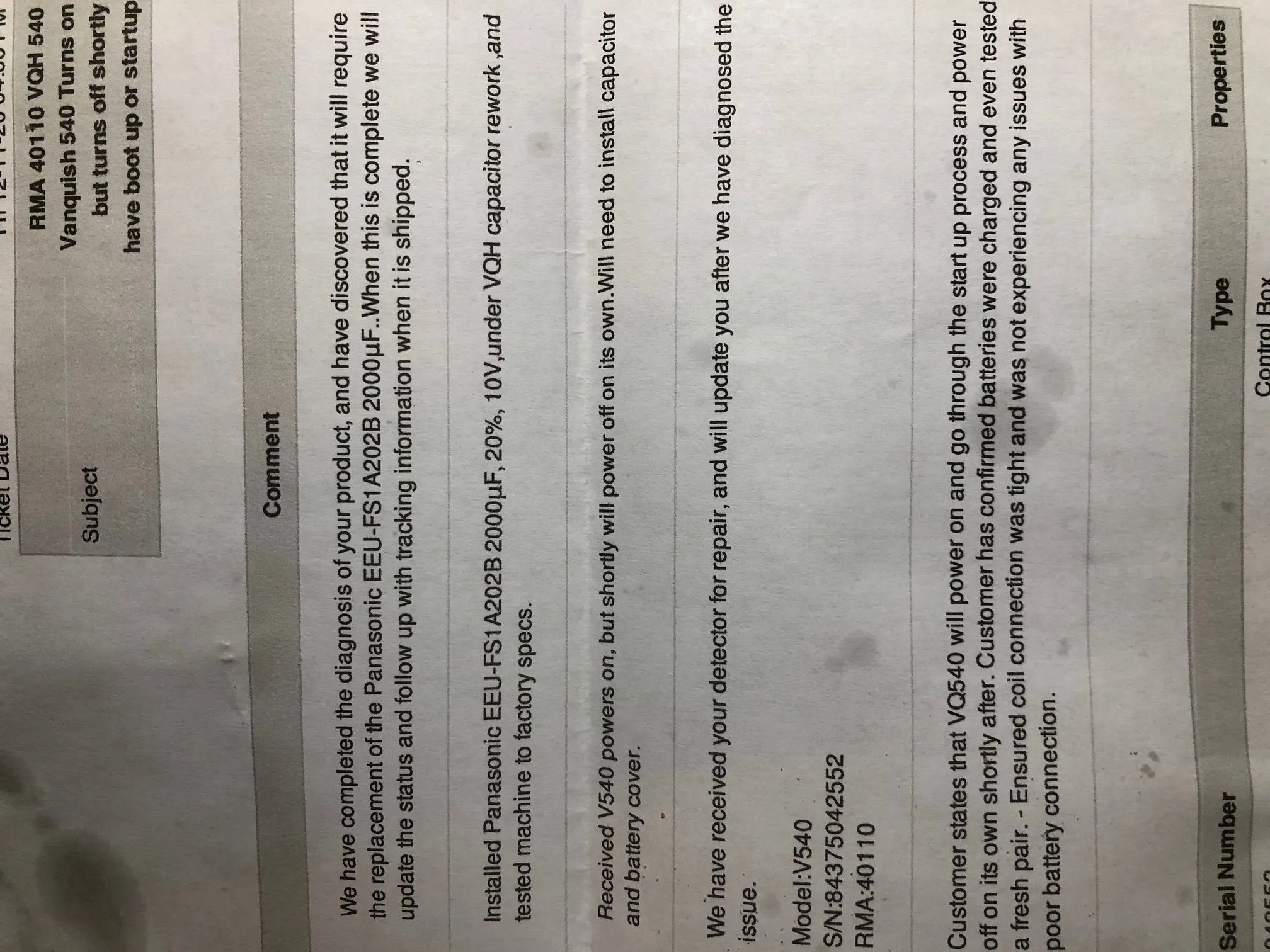

Got the detector back along with diagnosis note, parts had to be replaced.
I trust they did a good repair, probably won't test it out until the spring but I'll fire it up and do some quick tests to make sure it is working

Well, finally got around to testing it.
Does the same exact thing, starts to power up then shuts rights down - And yes, batteries are fine, I have a voltage tester.
So now, spend another $30 to ship it back AGAIN and hope they actually repair it or better yet, replace it ?
Don't know, think I'll more likely cut my losses, throw this thing in the trash and never buy another minelab product again.
Not sure if anyone has mentioned this yet but the Vanquish battery compartment is roomy and with the cover on, one or more of the batteries could disengage from the contacts. I read about this shortly after buying my 540 and sure enough mine would power off at times too. I cut a square piece of soft foam (about 1/2" thick) and place it between the batteries and cover. It has solved the problem for me.
DD
Can see that happening, wish it was something so simple.
Don't even have the batt cover on while testing, just to avoid that possibility. They are well charged and well seated, unit is defective after alleged repair.
