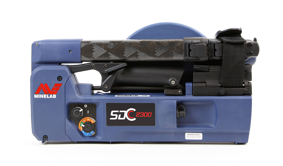

Just made the complete switch to Minelab machines. Took me a while but I finally woke up. Anyway I was wondering why Minelab doesn't have a dedicated waterproof PI machine for the beach? I would buy one in a heartbeat, sure others would too. Is it because it would take away from GPX sales:dontknow:
The new SDC 2300 is their newest PI and is water proof.

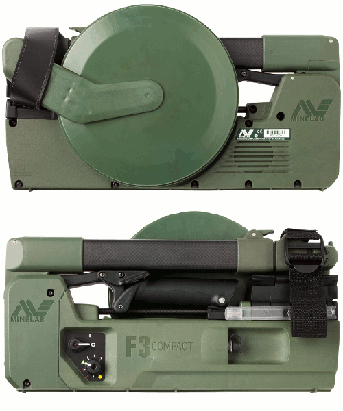

SDC 2300 is not new at all. It is a re market version of a professional mine detector. SDC has NO discrimination or sort off!!!!! = nightmare on the beach. I have tried it for 2 days when lunched as an adventure detector (only the color have changed), it's slow, heavy, can't change coil.... Compared to an ATX there is no possible discussion.
Depends of what you are looking for, but for the beach "in the water" PI detector, if you're looking to find small:
Garrett ATX "waterproof, almost", Whites TDI Pro (or SL if you upgrade to 14,4v), can't put the main unit in the water. Other PI machines for underwater use have a Pulse playback lecture over 20micro second, so are made to find "big and deep"...
Sorry but they are no ideal PI machine for shallow hunting, and SDC is certainly not a good way to go due to it's 100% lack of discrimination. If there was a killer PI machine for beach AND shallw/underwater hunting, I will already have it.

Maybe because the machines they already have work just as good without the annoyance of no discrimination.
F3 Compact Mine Detector | Minelab Countermine
SDC 2300 = F3 compact serie = Countermine detector, nothing more, nothing less (only blue color)

The sdc 2300 only has a hard wired 8" mono coil.
