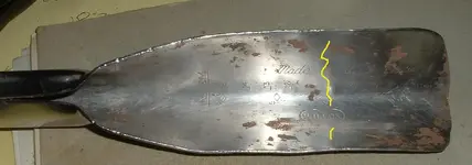

Oh I bent this back in the general area where I put the Yellow line, using it like a wedge
I absent Mindedley do that with roots & Rocks.
No idea how many I've broken & bent over the Years,
That's why I take a Hammer & round My scoops now
Looks Like I'm going to need to Reshape & Sharpen the Tip again for this year.
bent back :(
But with the Curve I can push it straight down in most soil, pull straight up
& it works like a Golf Hole Maker at times :tongue3:
I work allot of Gravel though

I've had issues of diggers bending or getting fatigue cracks along the blade. One simple solution is to run a welding bead or two along the length of the back edge to give it rigidity.
Thanks ! off hand I don't know any welders personally, But may look into it :thumbsup:

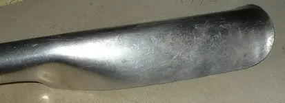

Being it is Too Cold to go out to my Garage
I did a quick Hammer & Doorstop correction.
I still need to take care if the center Lip and grind a bit,
but the proper equipment is out there in the cooold
When it's minus 25 with wind chills of -35+ it's hard to get motivated to do anything outside. Just add it to the to-do list Jeff I'm sure it won't be lonely there as my detecting equipment to do list is well under done.

The problem with re-hammering the bends is that the metal has already been stress weakened, and bending it straight weakens it further. I've never had a straightened digger last much longer after repair.
I've been doing this one pretty much every spring since I bought it.
& yes on occasion Several times a year. It is definitely Stressed
& actually from Grinding, a Few inches shorter then when I bought it I'm sure :laughing7:
it was probably a 22" or 24"
but it does it's job yet
