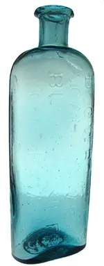

I've been busy doing my backyard bottlin and have finally started to see some punty shards coming out in addition to allot of 1900 and 1930's stuff :hello2:
Down in the deepest layer (presumed 1850's) I found this shard that I'm having trouble identifying. The bottle was either square or rectangular with chamfered edges. I'm guessing that it was a bitters or gin :icon_scratch:
Does anybody know what bottle this came from? :dontknow:

sodatraveler ~

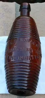

I don't know squat about bitters bottles, but since I enjoy a good search challenge, I went with what I could see of the name ... CK'S and came up with one that fits. Which is ...
Dr. C. W. Roback's Bitters
The only other thing that popped up was Horlick's Malted Milk, which is newer, round, and typically clear glass. Even the Roback's I found were round with amber glass. (See below). If I come up with anything else, or discover that Roback's made a square, green bottle, I'll let you know.

I forgot to mention that I also found references to a "Hendrick's Gin" but no pictures or history yet to support it.
SBB
Thanks SBB, that's allot more than I was able to find :notworthy:
It's most certainly not a Horlick's, but cudo's for thinking of it. I have a Horlick's and it didn't even cross my mind.....
The Roback's Bitters is a good possibility, but like you, all I can find is the Barrell Bottle version :icon_scratch:
Hendrick's Gin looks like a new product, but they do mention that the "pot" dates back to 1860 (whatever that means)
A little more data in case you (or anyone else) would still like to solve this mystery:
The vertical line showing on the right in the picture looks like the very start of the base of the bottle. The chamferred corner is at the bottom of the picture held between my fingers. It appears that the word "******CK'S" was embossed vertically down the center of the panel with the "S" ending about half an inch above the base. The letters are just shy of 1/2" tall and the bottle would have been about 3" wide on the side shown.
I've done some research on Dr. C. W. Roback and found that he produced a few other products - in a few other interesting bottles. There is a small rectangular aqua medicine bottle with his name and the far more interesting bottle shown below.
However, I've yet to see anything that matches my shard. :dontknow:

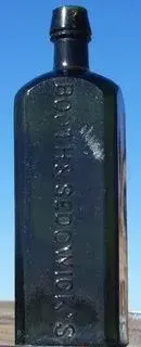

Could be a bitters, whiskey, schnapps, gin, or even a medicine. I don't recognize the bottle; but, maybe it's a shard of a BOOTH & SEDGWICK'S // LONDON // CORDIAL GIN bottle. That would make it a good, American bottle from 1855-1865. Does that fit?
Harry ~
Good job! :notworthy: Looks right to me.
Compare the two pictures below and notice how the K is done with the - (bar) across the center.
SBB
This Antique Bottle was recently sold at auction on eBay for $140.
The seller's description:
Booth & Sedgwick Pontil Gin Bottle Olive Green
"BOOTH & SEDGWICK'S - LONDON - CORDIAL GIN", forest/olive green, square, sand chip pontil scar, 7 7/16"H, applied sloping collar, dug and lightly cleaned retaining some light exterior dullness and minor ground wear. American, 1845-1855, very scarce. This crude, early pontiled gin bottle is blown from a particularly seedy batch of forest tinged olive green bottle glass.

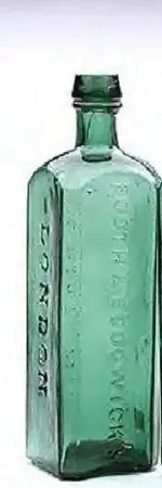

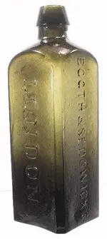

Now that I know the name of the bottle, I was able to find several examples of various ages - and finishes! :hello2:
The first one is by far the best color match, but not the best picture. The other two show a different finish. It appears that this is a moderately rare bottle, but there are quite a few out there. I may have to find the base of this bottle to know the age for sure.....

I can't make out the first picture, but the K's on the other two bottles are slightly different with what appears to be a more 'slanted' center bar. I'm not sure if this will help date yours, but it might.
SBB
SBB
Good observation! :icon_thumleft:
The Hawaii collectors (which sort of includes me) spend a great deal of effort analyzing minute differences in embossing to determine which specific variety of Hawaiian BIMAL they have. The book Hawaiian Bottles of Long Ago assigns a different number to each unique variety and a simple thing like the angle of the bar in the letter K can mean the difference between a common $20 bottle and an uber-rare $1000 bottle! :read2:
The first eBay picture you posted indeed matches the shard better than the other examples. The one with the similar finish and better color match was posted on worthpoint.com. The picture appears to be from the side embossed CORDIAL GIN, so even a clearer shot wouldn't help much.
