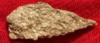

I have several ores and samples that I've collected after crushing and panning. If I post photos can anyone help me to identify what it is I have, Like to know if I had something of value and want to make sure I don't have anything toxic????????????? ore.webp20150113_043520.webp20150113_043538.webp20150113_043636.webp20150113_043653.webp20150113_043719.webp20150113_043735.webp20150113_043820.webp20150113_043847.webp20150113_044046.webp20150113_044052.webp20150113_044133.webp20150113_044219.webp20150113_044241.webp20150113_044253.webp20150113_044321.webp20150113_044336.webp20150113_044514.webp20150113_044537.webp20150113_044617.webp20150113_044642.webp20150113_044654.webp20150113_044709.webp20150113_044744.webp20150113_044755.webp20150113_044832.webp20150113_044854.webp

Looks like pyrites in matrix. Silver is unlikely however if crushed and panned one could see if there is any gold associated with them.
Here is some of what i've panned from these and other samples but most of the stuff that came from the photos above was silver in color, how can i tell if this is gold?gold.webpore.webpore1.webpore3.webpore4.webpore5.webpore6.webpore7.webpore8.webpore9.webpore10.webpore11.webp
Some of the later pics look more promising to me - One of those white quartz pieces looks very good indeed - perhaps some
natural daylight pics would show them better .

From the looks of it I'd say it's Sulfanediide, substitutive, Sulfide - additive...Commonly called a sulfide deposits. Those rocks will have a host of minerals with in it. Are you picking these up from some old mine waste tailings somewhere? An assay will be the only way to tell what for sure is in those rocks. Iron pyrite is there for sure. Could have lead, zinc, copper, cadmium, molybdenum disulfide gold, silver and many other elements. Is it worth the cost to mill and process, if you have tons and tons of it. :dontknow: Only and assay will tell you that.

Mash a piece. If it's pyrite, it will shatter, or crumble. If gold it will mash and deform.
In water pyrites will look darker, gold will not.
Unscientific, but an easy test.
