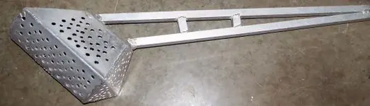

Funny you would post this as I was ready to do it on another forum, because I meet this past weekend with a design engineer on this subject. He had came up with a few new designs that he had models of and asked what I thought. Both were light, But one was very. Both had Lots of Holes, fiberglass handles, 6.5 inch x 12 inch buckets laser cut, all tig welded, very comfortable angle on the back to dig with, one was SS, the lighter of the two he would not say. His question was, would I pay extra for the less weight and extra work that went into it. {no price was discusted} With this I said I would like to field test both, and see if it is worth it {one was 14 gauge SS at less then 5 lbs., the other was less then 4 lbs. and .050 thick}. I took pictures of both but he ask they not be sent out or posted. I loved both, but I'm set for beach scoops, but the weight is a big factor, and I want one I can weld or get fixed without having to send it out. Plus A handle is a big plus. I know what MTP is talking about, every beach is different and requires different tools. I have been looking for a Miller scoop for the Bay and his lower bucket with a bent handle would work great, but I don't think it would be the right design with the fiberglass handle for the bay...... So in order, my priorities are.... Weight, Durability/Functionable Design, and Price...I'll be in OC/MD the 27th & 28th to test, then maybe the Bay a few days later...hope I can do a little video of each.......Joe

i got an idea how about a titanium scoop super light super strong might be the best ever and damn expensive anyone thoughts on this one?

as an example the metal for a 14 ga. stainless water scoop might cost approx. $10.00 to $20.00 that exact same scoop made with .050 titanium would cost in the neighborhood of $100 to $200.00. the titanium would be stronger and only weigh about 2/3's of the stainless scoop, but remember that scoop full of bottom is going to be just as heavy regardless of what metal its made of. titanium is not nearly as friendly to work with, for instance it doesn't like to be formed into a 90 deg bend & and if you drill it you better have good bits, the right feed rate or lots of time & cheap bits!
i've seen many complaints about the cost of the better stainless scoops, do you think anyone would pay 2 1/2 to 5 times that cost to carry a scoop thats 1.5 lb's lighter? i don't but i may be wrong.

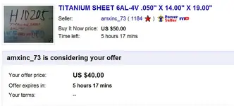

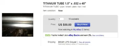

I looking for a scoop for the older years, when carrying around a SS scoop of 5 to 6 pounds will be more of a task......where as one Of Titianum {three pounds} will be easier to deal with. I can get the stuff, and got a good man on it right now. Material is about 150..and labor is about the same..so 300 for a life time scoop that weights 3 pounds?? Joe
