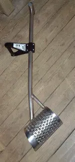

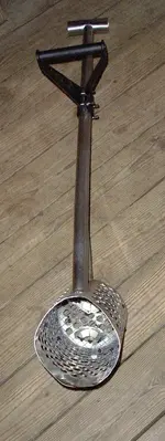

Here is mine. I got the scoop for $75.00 and then added the galvanized wire mesh and (2) magnets from an old Computer Hardrive.
Works well and the magnets and wire mesh help keep the small items (bobbie pins) from passing through the holes.
I have now added a handle on to my wet sand scoop to make it easier to get out of the hole when the suction has a hold of it.

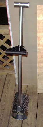

Best of everything. Light, big, SS lip for the wet, Screen for the dry. Very fast draining.
Well let me tell ya. I used a couple different duck bill styles. Both stainless and aluminum with the angled handle design. They worked fine but I did lose tiny items through the 1/2" and 5/8" holes. I am sure they were all diamond ear ring! LOL
My friend told me to try his straight handled design with a wooden handle. 3 years now and i'm not going back! This is a great scoop. I can let go of it in the water and the handle is always right there floating by me. The small hole design keeps the small items in the scoop, and the top guard keeps the floaters from escaping. Also this scoop is built stronger than the others like it.

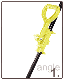

Hello Everyone,
I would like to add an additional handle to my scoop like the one shown by MT Pockets or Big1011Guy - are there aftermarket ones available? If so where do I get one? Or do I have to fabricate my own? Finally, about how high above the scoop should it be mounted? Thanks.
Darryl
nuggetshooter said:
Hello Everyone,
Darryl
Hey Darryl
My handle is after market. It has 4 screws and nuts that hold it in place. As far as where to place it you will have to try the handle in different placements, till you find the one placement that is comfortable to you. I like mine, it works great for me.
The price was around $21.00 including shipping.
Here is the link to the online store: http://www.Backsavergrip.com

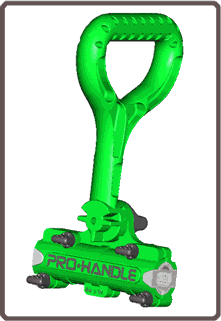

nuggetshooter said:
Hello Everyone,
Darryl
Kellyco carries them, they are aftermarket and called pro-handle....Some Home Depots carry them as well....
All the hardware is stainless steel, will never rust, the adjustiblity is really nice, it blows away every other handle I have ever used. I use to use the backsaver, but after trying the pro-handle, I switched to it and never looked back...
