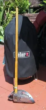

Here is my prototype for moding the Sun Spot. It sets the handle to 20 degree's. I am still looking for the right hardware for the finished product, and I will marine epoxy the shim and some other minor tweaks. Digging in the backyard it feels rock solid. This weekend I will test it in the water. So far the new angle feels awesome. 1st pic is before mod., the rest after mod.
Also, even with the shim and longer hardware the scoop still weighs less than 6 pounds. HH.
