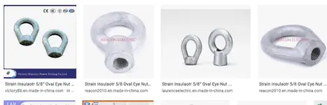

When I was a teen, I worked as a ground hand for the power company. They use to have galvanized eye nuts of all different sizes on the trucks. Not sure what all they were used for, although the larger ones were used for guy wires as I recall.
I remember now.. A Google search refreshed my memory. They were used fro deadening suspension and strain insulators.
Agree with Mud Hut. I have found those near power lines.
They are used as part of the anchoring system for power poles. They would
set a screw anchor, then run heavy guy wires to the pole.
