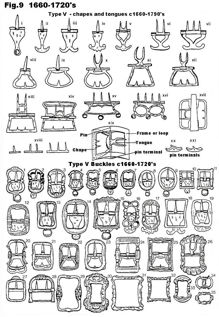

hope this helps
It's a SNAP buckle :icon_sunny:
You might be right. We could probably tell if the picture was a little bigger. ;D
Daryl
Just a WAG...
Type V Buckle c1660 - 1720s (check out #5)
BUCKLES WITH STUD CHAPES - (no's 1-15)
These were used for shoes and for fastening the breeches knee-band below the knee and because of the small size of early shoe buckles they are difficult to differentiate. Buckles with a pronounced curve as number 15 are definitely shoe buckles.
That is a great chart!!!! Where can I find something like that? I think u hit the mark! It looks like a cross between #5 and # 17. Very similar to 17. What are these buckles normally made of? Way to go!!! Thanks!
J

It's from the website linked here: http://www.ukdfd.co.uk/ceejays_site/pages/buckletitlepage.htm
The text information is listed seperatly from the pictured information, but, you should find the site easy to use and a great research tool :)
Agree with Jim, it is late 17th century.
