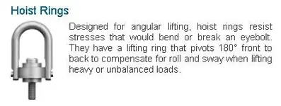

Consider one of these,......
Just one small tool, an Allen wrench.
Perfect for lifting a load without stress to the set up.

I understand all the replies, thanks to you all. I have purchased this magnet simply for the fact I wanted to be able to adapt 1 magnet to different conditions... and because I lost my last magnet,lol. I should note that my last magnet wasnt lost because the eyelet came loose. My father uses a locking nut on his magnet, but after our last trip he noticed it had failed and his eyelet was halfway unscrewed. I haven't put a whole bunch of money into the magnet, but I'd obviously rather not lose it. I'm thinking some blue thread lock will be my best bet. I already know its strength and it is removable with hand tools. I like those hoist rings as well! Any other opinions or advice are always appreciated! I'll be looking into all options.
