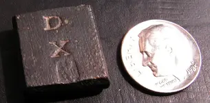

Well here is another thing I can't seem to find any information on. So Help!
I found this in a Revolutionary War period camp area, so it has to be from then. ;D
I would think that the "D" and "X" would be Drachma times ten or Dram times ten but it weighs 15.02 grams so these don't fit from what I can find.
The "Rampant Lion" seems to indicate Dutch origin to me but I can't find any apothecary or coin weights with these letters, this mark, this shape, or this size.
So I'm stumped.
Ideas? Found one like it?
Thanks,
Daryl

Some type of coin weight perhaps :icon_scratch:

I thought it could be an apothecary or coin weight or a calibration scale weight but can't find any like it. Been there. Done that.

Bullion weight?
It's ten pennyweight, which works out to 15.5 grams. I guessed this because carpenters still use "D" as an abbreviation for pennyweight. For instance, a ten pennyweight nail is "10 D".

Cool. So tell me more if you can.

It looks like you have a 10 pennyweight scale measure ... it should weigh out to 15.5 g according to weight conversion chart. Your find may have lost a little over the years

And the "Rampant Lion" hallmark would tell us?????
Dutch?
Any idea of time period?

The dutch do use a rampant lion on devices , however another country does too , even more so.The lion rampant is the symbol of Scotland.Have a look at the flag and coins.

you guessed it, its a Scottish Ten pennyweight for bullion circa 1700s. Interesting it was normally only the 4 pennyweight counterstamped with the rampant Lion, so a little more unusual :icon_thumright:
