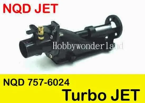

http://www.ebay.com/itm/NQD-757-602...d=100012&rk=4&rkt=10&mehot=pp&sd=400920980784
