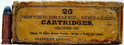

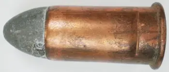

Meanwhile, here's a sideview photo showing some Benet-Primer cartidges. Note that just above the casing's base-rim, there is a shallow indentation, one on each side of the casing. There is a small gap between their ends of the indentations, meaning they do not completely encircle the casing.
Benet-Primer casings have a tiny short projection at the center of the inside of the casing's bottom. Is that like yours, or is the inside of the bottom simply flat?
There is another type of slightly-post-civil-war casing primer which resembles a rimfire, but isn't. It is the Bar-Anvil primer. Go to the following webpage (a cartridge-collector Glossary), and scroll down for definition and illustrations of the Benet-Primer and Bar-Anvil primer. Does your casing have the bar across the bottom of its interior? A Cartridge Collector's Glossary - International Ammunition Association
  • cartridge_POSTWAR_Benet-Primer_50-caliber_dated1872_FrankfordArsenal_5070FA1872.webp

  • cartridge_POSTWAR_Benet-primer_58-caliber_1866-Allin-Martin-conversion-Springfield_photobyIan...webp
