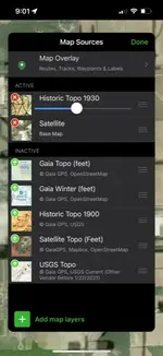

On the Gaia App there is a "Historic Topo 1930 map you can control the contrast of the map about 40% if usually good laid over the current satellite image and see the black/gray image of houses and approx where they used to sit. You can hold on the map to draw measurements if that helps. I included a couple sample pics if that helps.

On the Gaia App there is a "Historic Topo 1930 map you can control the contrast of the map about 40% if usually good laid over the current satellite image and see the black/gray image of houses and approx where they used to sit. You can hold on the map to draw measurements if that helps. I included a couple sample pics if that helps. View attachment 2019172
Thanks for the info you helped me with the Gaia app with this location earlier. I am still learning the Nox very good machine lots of good settings to tweak. Takes a lot of learning to get it perfect. You know what would be a dream if there was a app like Gaia but also you could click the dark house spots and find any info on the house. For example pictures deeds newspaper articles. I am about to post a very interesting one that I need dating. Maybe the best one yet I found
