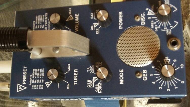

whites coinmaster 5000/D Series 3 instruction manual or the settings does anyone have to tell someone there is
grasviti
Grasviti, welcome to the forum. That is circa very early 1980s.
If it had just been a 5000D (without the "series II or series II) it would be a VLF/TR dinosaur . But the "Series II" incorporated motion discrimination . Which would make it very similar to the 6000D series I. And the "series III" introduced a depth meter.
Still pretty much a dinosaur, when compared to today's machines. But at least it was motion discrimination . Albeit a fast swing, not good at target separation, and lacking depth when compared to today's power-houses. And no TID.
They were actually a very good wet salt beach machine though.
The 5000 / D 3 series is not good

The 5000 / D 3 series is not good ...
compared to what ? If you put it in GEB disc, and ground balance properly, You'll cut through wet salt and modest minerals just fine. I bet you can get a dime-sized target to perhaps 8". Sure there's machines today that go a tad deeper with ease. And sure there's machines today that separate better with no loss of depth.
But that machine of yours is not an utter loss. If you're using it correctly, and so long as you're not competing in places with today's super-marvels, you'll do ok.

That is a decent older machine. Run in GEB normal and if you get a weak signal flip over to TR discriminate and give a sweep. If it says bad then don't dig but if it says good or doesn't say anything then dig. It should fine dimes at 8" depending on soil.
mud-flap, this advice makes me think you're thinking it's the original 5000d (which was a vlf/tr). Your instructions would be for someone using a TR discriminator. By the time motion disc (aka GEB disc, or VLF disc) hit the market in the late 1970s, hardly anyone ever used TR disc. Even if (like in this case) it was still an optional control. I suppose there were some people who might have needed it for super tight confines to discriminate (when motion wasn't an option, or when it was super junky like under bleachers or something).
But most people who this generation of the machine, would swing in GEB disc, then switch to GEB normal for pinpointing, or some other need when they wanted to hunt all metal.
Your right. Wasn't paying attention. Should have looked at the pic too! I used a 5DB back then but sold Whites for a while in the early 70s and the 5000D was a hot seller and a killer machine on silver dimes for some reason.
