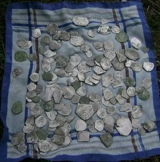

this is pic of 3.2 kgm treasure .found less than 50 cm .whith my detector v100.

Hi ilyes1113. Were those coins in your pix found one-at-a-time? As in regular coin-hunting? Or were they found in a cache (box, jar, or whatever)? If they were found in a cache, and assuming that the ones in your pix were the entire stash, then those would fit neatly in a small soda-sized can. So no, a soda sized can will not be found at 9 ft. with the TM808. And no, no detector of any sort will find individual coins at much beyond 1 ft.
So let us know, are those singular coin finds in your pix? Or were those all in a single cache? Congratz on the cool coins! You're making a lot of us Americans drool. Heck, over here we consider a coin that's a mere 200 to 300 yrs. old to be OLD. Over where you are, I guess that would be the pesky "new" stuff :)
yes sir.the spanish cobs .420 coins.3.2 kgm found us a lot in a jar less than 50 cm under ground.
the other coins moste of them are roman coins.silver-bronz... found individualy .10 cm max undr g...
i think that the individual coins founded can be solved from broken jars or boxes more profend

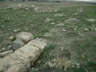

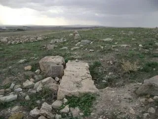

this is a picter from the antique site

Then if that jar was less than 50 cm (about 1.5 ft, which is well within range of even standard coin machines to get a jar at that depth), then why do you think you need to reach 9 ft.? And bear in mind too, that if you get a 2 box machine like the TM808, you will no longer be able to detect for the individual coins (unless you bring two machines for the hunt, and hunt with each). Perhaps that is the solution: Just have both a coin-machine, and a 2-box machine. Hunt the sites with each, and you can't loose :)
As for the solo coins, they aren't necessarily scattered from a broken open cache. They could simply be fumble fingers losses (as is not unusual for any old habitation/settlements) of ancient times.
P.S. What is a "V100" metal detector? If I was you, and I had access to ancient sites like that, giving up choice old silver coins like that, I'd get a top-of-the-line coin machine and cover that place with a fine-tooth comb! :)
