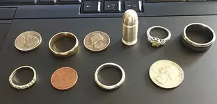

I ran some air tests in my yard today with my CTX to see how it responded to depth, sound, and number. Here are the results:
Settings:
Coil: 17 inch
Sensitivity: 26
Pattern: All metal but last line
Tone: Combined
Deep on
Seawater on
Pitch long
Speaker - no headphones.
Findings:
Mens 10k Gold band: 16 inches
Mens 14k thin white gold band: 14 inches
Womens 14k White gold wedding band: 8-9 inches
Tungsten Junk Ring Mens Wedding Band: 17 inches
Wheat Penny: 15 inches
1oz silver bullet: 11 inches
Silver nickel: 13 inches
Regular nickel: 13 inches
Quarter: 16 inches
Silver ring: 14 inches
Picture of items. All of these are finds of mine except the silver 1oz bullet:
edit: Oh, the most interesting find...that gold 10k band kept ringing up as 12.36/12.37/12.38...
