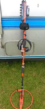

I'm thinking about getting a WOT for my Excal. Mostly beach hunt,so drag in the water is no biggie.From some of you folks who have had 'em (Max) what are some other pros and cons? Weight, sensitivity,etc....
Also can you use a Stainless bolt on the coil to rod connection on an Excal? My Nautilus uses one , and seems fine.

Speaking from just my own experience, but I personally love the combination. In my opinion you can't beat the WOT coil in the water. I have a waterproofed sovereign GT that has a WOT and when it was down for repair I borrowed Excal from Clyp that had a WOT coil. I just bought another Excal and I am going to put a WOT coil on it for use in the surf.
Get the harness, weight will not be an issue. Using a harness, I can swing excal with WOT coil all day long and I am 61. I have turned both my hunting partners Clyp and Pockets on to the harness and they can vouch for how much easier it makes hunting.
I have 2 WOT coils, one on my waterproofed sovereign gt and the other on my beach/land sovereign gt, and both of them have proven to be "hot" coils and both are very deep and very easy to pinpoint with.
On a scale of 1-10 I would give the WOT an 11. :icon_thumright: :icon_thumright:
Good luck and good hunting..................

  • Excal:WOT.webp
  • Excal:WOT.webp

Never used a WOT, but no one addressed the stainless bolt issue. You CANNOT use a stainless bolt with an Excal, without causing falsing issues. I upgraded the stock bolt by drilling the coil ears and lower stem to 5/16" and went with a nylon bolt and wing nut from the hardware store. Coil stays put now, I like it!

Gulf hunter Thanks. I wonder why the bolt doesn't effect the 15" coil on my(came stock with) Nautilus dmcIIb? If it does I'm gonna have to get a backhoe. When you drilled out the hole ,it didn't get into anything that would effect the waterproofness of the coil did it?

like gulfhunter said................STAY AWAY FROM THE S/S BOLT FOR YOUR COIL - my opinion only
