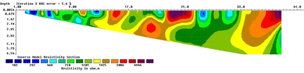

Mostly they have software that switches the resistance measured. That data is entered into a software that does an "inversion" and outputs a graphic of what lies beneath. The visualized depth is determined by the probe spacing...generally, the depth seen is 50% of the probe spacing. Here's a pic of what the output resembles:
This was from my pasture during my learning process. Blue is low resistivity, green is moderate. Red/orange is high and is probably basalt lava that underlies the pasture. green is likely gravel from the Snake River, as it ran through most of this country at one time or another. it's now about 50' lower than here and 3/4 mile away. The software I use is free, and only 2D. There is a 3D version, but it's costly.
