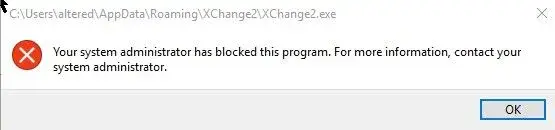

xchange will not run on win 10 . Version XChange2-1.8.7-1.1.10. Get an error like this below?
Tried running as administrator and it never opens. Tried changing the setting for compatibility?

funny thing is there is no uninstall unless i use the folder int he start menu. But the most strange thing is the install location but there is no way to change the install location.
C:\Users\altered\AppData\Roaming\XChange2\XChange2.exe -d'.\' -n'mldata' -r

Yes i just meant that it was never installed before, but yes uninstalled, ran cc cleaner to remove all traces, ran registry cleaner and even ran regedit and deleted andy souce of xchange or minelab and deleted those sources as well.

I have no idea at this point. I have removed and installed a lot now haha. i am showing that i the administrator have full control and full right to all files in the folder so not sure why i still get the permissions issue. I ahve also looked and there are not software group polocies on this laptop.
The install location is the problem. They need to change this software so that users can switch. Many times you are blocked out of the AppData folder and get that error. I was only able to install by right clicking on the install file and choosing run as administrator. Otherwise I got that same error on 3 different machines all running windown 7, 8, and 10
When I use it (on my Windows 10 machine) I do need to disable my antivirus for it to run. Other than that, works for me.
