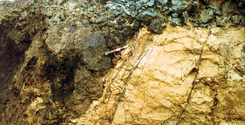

Thanks. The one piece of exposed rock on the hillside (either limonite or yellow gossan) has a verticle vein on the top running into the ground. It is about only 6 inches above the surface. It is contrasting brownish coloration to the yellow rock. I might just dig into it. The nugget was crustalline and paper thin. I know it is a lode or vein somewhere on the hill. I only get there once per year in the spring.
The outcrops are like this. Should I dig into them?

Sounds like you found a piece of coarse hard rock gold near an outcropping.
I would concentrate on detecting a 25' wide strip of ground directly down hill of the outcropping. I'd carry that line down the hill about 300'.
You may find more float gold detecting than you would find digging ore and crushing/processing it.
Large coils
VLF then PI detector.
If there is no indication of past mining, I'd definitely be doing some minor investigative digging.
If it's not claimed, file a notice with the county and start prospecting.
