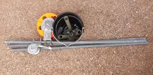

Tripod ready.
Whole assembly including bucket and line only 43 lbs.
attachment.php
attachment.php
The telescoping leg extensions if needed, sledge hammer, stakes, and tie down straps will add around another 15-20 lbs. so I've hit my target of 50-60 lbs. for the initial carry uphill. Total cost around $100. More than I wanted to spend but it will pay for itself in saved trips hiking up and down hill all day.
Check out that bucket purchased at C-A-L Ranch $9.95, heavy duty, notched bail, shorter depth, still holds 5gal. :icon_thumleft:
Now just waiting for the wire cable to arrive so I can field test it.
GG~
