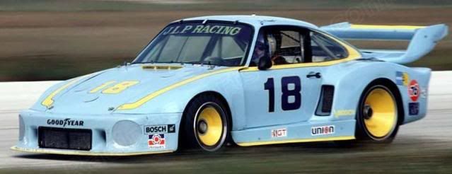

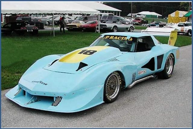

Keith, I was involved with sports cars for many years but have been out of it for awhile. We did endurance races like the 24 Hours of Daytona, 12 Hours of Sebring, and LeMans once. This was back in the 60's, 70's and 80's. The International Motor Sports Assn. (IMSA) was the sanctioning organization. I was very familiar with Riverside having been there quite a few times over the early years. Shame they bulldozed it. I also did some formula car (open wheel) racing so know about interlocking wheels and the results of doing it. ( Here are a couple of photos I have on this computer.
I did a little driving in the early sixties but realized I was a much better mechanic/fabricator. I ended up being Team Manager/Crew Chief for most of my racing career. I even helped build an offroad Blazer for the Baja 1000 but the kids driving it destroyed it very early in the race. They never ran it again except on their daddy's ranch in Texas. ) Congrats on your outstanding accomplishments in racing.
Keith, I was involved with sports cars for many years but have been out of it for awhile. We did endurance races like the 24 Hours of Daytona, 12 Hours of Sebring, and LeMans once. This was back in the 60's, 70's and 80's. The International Motor Sports Assn. (IMSA) was the sanctioning organization. I was very familiar with Riverside having been there quite a few times over the early years. Shame they bulldozed it. I also did some formula car (open wheel) racing so know about interlocking wheels and the results of doing it. I did a little driving in the early sixties but realized I was a much better mechanic/fabricator. I ended up being Team Manager/Crew Chief for most of my racing career. I even helped build an offroad Blazer for the Baja 1000 but the kids driving it destroyed it very early in the race. They never ran it again except on their daddy's ranch in Texas. Congrats on your outstanding accomplishments in racing.
Stan nice photos. Yeah rather sad that the old track was taken down in Riverside. Today off-road racing is a rich mans sport. Trucks costing a million dollars or more are being built and the transmissions costing a quarter of a million alone. Yet the payout "Purse Money" is nothing. Its all about being recognized as being a winner of the toughest off-road race ever, that being Baja 1000. People in here complain about Valley Fever while dry washing. Try following hundreds of vehicles across the desert for 1000 miles.
