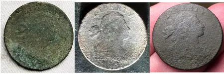

Since I just went through the cleaning process with a similar (not as good) coin, I thought I would share some photos. This might help you decide how much to clean. Personally, I wish that I had stopped with the dry cleaning, but I'm still happy with what I have.
The first pic is uncleaned, although it looks like I might have rubbed at the location where the date would be.
The second pic is just tooth picked and dry brushed.
The third pic is after cleaning in hot peroxide.
I think your date might be there. I would start with cleaning it dry, and see what you have.
