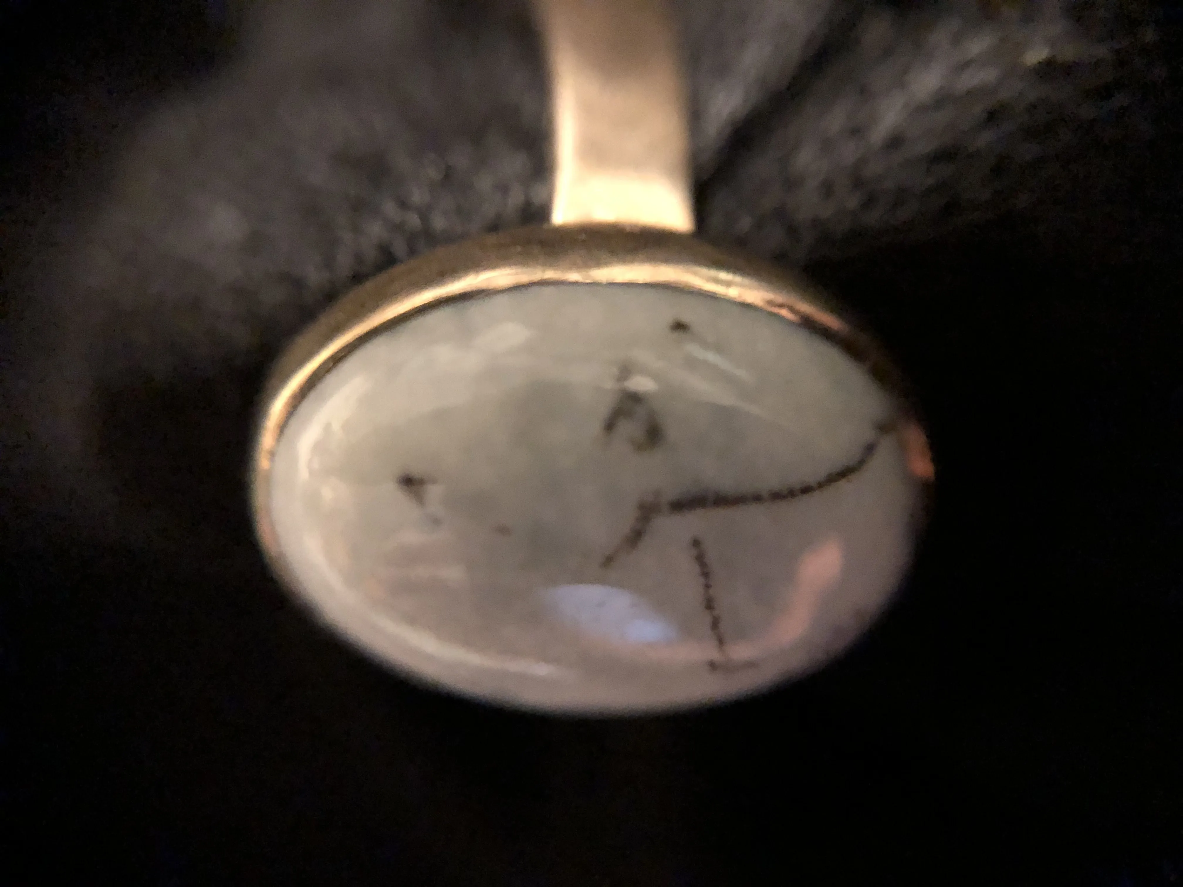

i have a new rule for myself since the '24, ... dig ALL targets in the 20s' range. Just about the time you become sick of pull-tabs as you curse the 'new rule', ... GOLD appears
about 7" down
Nice! The SP24 is so accurate on pinpoint is really not to difficult to find the target. I’m going back and dig everything till I can’t stand it....or I find gold!
