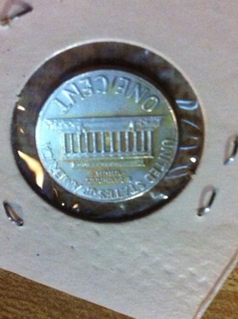

Found this yesterday and was wondering if anybody had any ideas.
Web look-ups say it might be a penny that wasn't copper coated
and another says it may be a phony.
I'm not sure. Any suggestions.
Thanks for the suggestions and help.
Bobby
It's been plated.
I really can't give an opinion as to whether it is plated or a Zinc Planchet that never got the Copper Plating or the Copper Plating was removed by acid. To even attempt to determine any of the above, one really needs the coin in hand to do so but even then, the analysis can be uncertain.
Frank
It's too shiny to be zinc without the plating. Just like the 1943 cents the should be a dull finish. The plated ones are shiny. This coin has been plated by someone outside the mint.
HH
enamel7
You can even see the copper showing through on the reverse.
Yes. Its very shiny almost like a new dime or quarter. The after mint plating sounds most likely.
Thanks for the responses.
Bobby
Everybody has covered it pretty well, so no new info here, but thought you might find this interesting... I'm a chemistry teacher and we do this lab every year at some point. If you zinc plate it and then heat it, you end up with a brass coating as explained in that link posted above.
