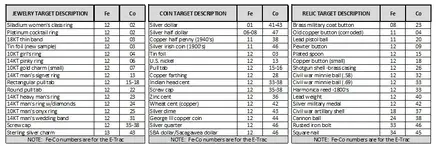

These are for the Etrac, but the numbers are usually the same on the CTX
I'm having to scan some spreadsheets and will post those as soon as I get them done. TNet doesn't take xls files.
I don't remember where I found them or who to credit. But the spreadsheets were comparing Etrac to Explorer and DFX numbers. Here's 3 more files. They were in digital spreadsheets, couldn't upload, so I had to print them, and then scan them. Then had to clip out the useless info. So, it took a bit. The images are not of the greatest quality, but should provide some good test results.
Update! I credit Chris Boroughs "The beep goes on"
Coins
Gold Jewelry
Silver Jewelry
To answer your question, no. There is nothing but iron in the FE 35 area. If you might have iron artifacts like cannon balls, then those #s would be worth digging, otherwise they are junk.
