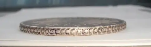

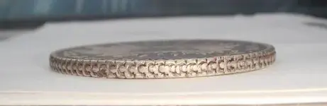

Hi everyone! First of all im a newbie at coin collecting and just getting into the hobby, I purchased a Mexican 8 Reales 1882 Silver Coin for about $23.00 and i was content with my purchase but recently ive been reading alot about all these scams, frauds, & fake coins. Which frankly has made me a little worried about my coin so I would greatly appreciate it if all you fellow coin collectors could take a look at the coin and give me your opinions. I know theres only so much you can tell from a picture but nevertheless i would like to know your thoughts.
Also i have read that a surefire way of determining wheter one of these coins is a fake is by finding out the weight of the coin, is this true? And what should this coin weigh?
Thank You very much, and thanks for taking a look at this coin.

I'm no expert but it looks real.That particular coin was not rare, so I wouldn't think it would be counterfeited for that reason,the value is about right I would think.They did make "replicas" though.If you have a loupe or a magnifying glass,take a look on the reverse between the eagles wing and Mexicana,if it is a "replica" coin,you may see remnants of the word "copy" or filing or buff marks from it being removed.Also, it should weigh very close to 27.468 grams I believe.I hope it's a real reale,if not at least you didn't lose that much for a lesson learned.Good luck.Here's a photo of a real one with counterstamps.

I don't know, look at how uneven your coin is, in respect to it's roundness. It seems squished on the sides in a couple of places. Plus there is some kind of marking between the words on the back, and yours doesn't have that marking that I can see.

I found something similar in a mixed bag of foreign coins. It was a 1882, 8 reals Mexican coin, silver in color. Well Krauss catalog said it was silver. Since then, I've researched on ebay and found listings for fake reals. The best way to tell is see if it will stick to a magnet. We all know silver isn't magnetized.... mine stuck to the magnet >:( Luckily I didn't give much for the lot. Still a conversation piece worth a few bucks anyway...

Also, mine has the edge like a half dollar... yours looks more "layered"..

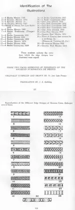

It definitely looks real.
The key is the reeding on the edge. Here are some examples from a 1963 Book "The Coins of Mexico 1536-1963" by Neil Utberg.
Yours matches with illustration# 14 (as it should).
Enjoy,
Mike

Thank You very much! Gollum those illustrations are very helpful, ill actually keep those for future reference.
