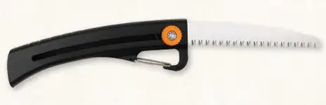

I carry one of these. It's made by Fiskars and the blade slides into the handle.
Diggem'
