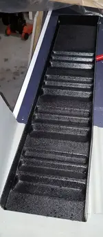

DIY 8" trommel I'm building.
Plan to use gold hog mats. Just thought I'd share my progress so far...

Hopper/collector right now is being redone...
I had the hopper above the barrel with the flow goin in to a collector then to the barrel. Turned out the hopper would be sky high (42") after the sluice drop was figured in...
Decided to go with what I know and got another drop riffle sluice. 8"x3'.
