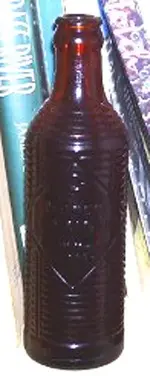

Or anyone else that may know. Would the small 7oz. Orange Crush bottle on the left have originally been an ACL bottle or did it come like this?

It's called an Amber ‘krinkly’ bottle, diamond front, fully embossed. My bottle is the wider 2 1/4in wide and the standard 7 3/4in tall. It's made by duraglas with the numbers 9 and 4 on either side of the Owens-Illinois logo on the underside of the base.
Question- The bottom of the base has what looks like C or G 909 embossed on it. The seam on the bottle curves at the base.Is that an effect caused by the base being applied during the ABM process while the glass is hot? Because it looks like the base was attached seperately during the manufacturing process.
Diggum ~

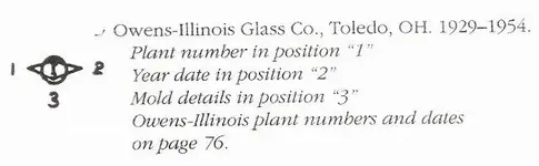

Correcto mundo! Good job. Your bottle is fully embossed and was never intended to have a painted label (ACL). The C?/G? 909 is a mold or tracking number of some kind. The Owens-Illinois / Duraglas mark ... (There should be a dot after the 4.)
9 <(I)> 4.
Duraglas
... would indicate that it was made in 1944. Owens-Illinois and Duraglas merged in 1940. So any bottle with the combined mark would be 1940 or later and easy to date. (See illustration below).

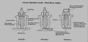

Automatic Bottle Machine (ABM) bottles were made in one piece, but involved various stages during the process. (See illustrations below). The entire process from gob (molten glass) injection to free-standing cooling of the bottle took about ten seconds. It's a little complicated to explain, but easy to understand when you actually see one of the machines in operation. ABMs were first introduced around 1905.
Bottle bases were part of the initial molding process, but in many cases they will have a visible mold seam. Prior to about 1892, (when the crown top was invented) soda and beer bottle closures (lips/tops) were applied seperately, but this process was, for the most part, discontinued by the turn of the century.

1. Owens-Illinois makers mark.
2. ABM stages 1-2-3
3. ABM stages 4-5-6

I see now . . . the bottle resembles Figure 16, not Figure 11 as I thought. I couldn't make out the embossing in the diamond in the original image -- old eyes, I guess. Thank you. I manipulated the image to see it better.
100_4093.webp​
Yes there is a dot after the four and further research tells me that the plant number 9 is Streator, Illinois.
