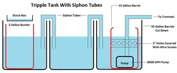

I would run it the entire length of the flare as you will get dirt caught on the outside of the flow and not wash down. Also I would go to a triple tank system to keep the water clean... The drawing is for my trommel but instead of pumping water to the trommel your pumping to the flare of your sluice.
How does one start the water flowing between the tanks using the siphon tubes?
Fill all three containers about 3/4 full
Hold the tubes upside down and let them fill with water, keep one end submerged and plug the other end with your thumb, take the plugged end and quickly make the jump to the next container.
Just make sure your tubes are long enough so that they go almost to the bottom of the containers, you don't want to run the risk of getting any air in them during operation.
The larger diameter the tube the better the flow, depending on the volume of water you might need to add a second tube.
Hope this helps
You need to be using large diameter pipe so that you do not drain your first tank dry. We use 3" cheap white irrigation pipe from HD. If your using three tanks you will need 4 elbows and 4 pipes. I would not make the pipes so long that your picking up the crap from the bottom of the tanks. Remember its better to oversize the pipes than be undersized. Once you shut your pump down the siphon pipes will balance the water within the tanks then stop flowing between tanks until you start your pump up again. To plug the 3" pipe to start the siphon use a rubber ball from the pet store. Once you have the pipe submerged under water plug one end of the pipe. Quickly place the pipe over the two tanks as seen in the drawing and remove the ball, the flow of water will begin between the two tanks until the water level is balance. If you have anymore questions PM me..
